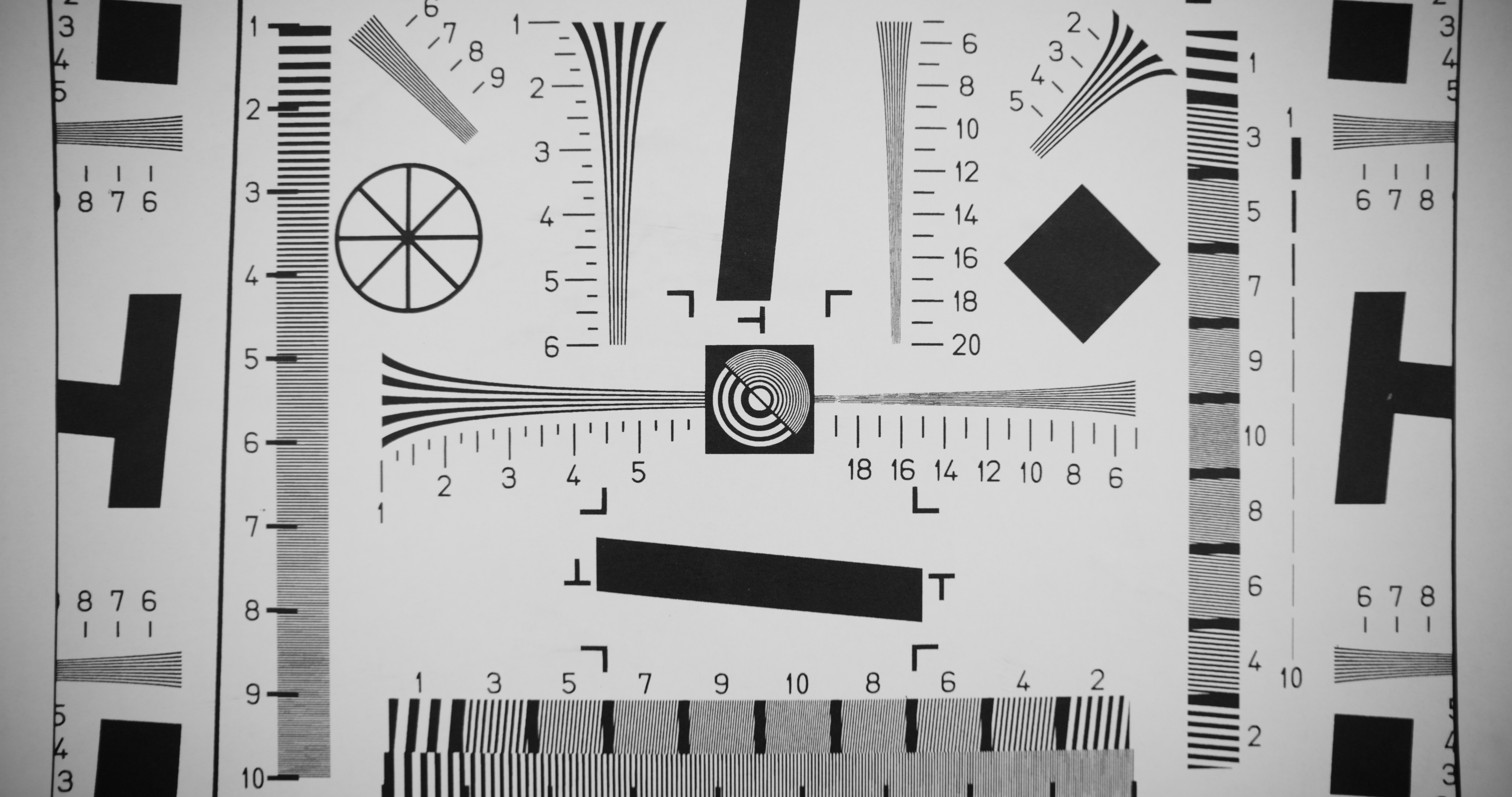

Can't compare them because I haven't seen or used the other two, but here are some chart shots at 15 cm close focus distance. Focused at T 1.4 and left unchanged for the other apertures.
Test chart home printed and illumination isn't 100% even either, so take it with a grain of salt.
T 1.4, T 1.8, T 2.0, T 2.4, T 2.8
And some curves for estimating vignetting.
T 1.4
T 1.8
T 2.0
T 2.4
T 2.8
Thanks, very helpful. The edges look pretty sharp for budget glass… What exactly are we looking at with the vignetting tests?
These are the brightness curves left to right for the chart shots, so even if doesn't show the 2D brightness distribution over the sensor area, like corners vs. edges, I think it gives a better representation of the fall off towards the sides when comparing different apertures than blank white frames where you estimate the brightness only visually.
Thanks for doing this. I think the 24mm would perform worse than the other focal lengths in these tests? I was thinking of pick up the 24 and 50…
Right, with the 24mm currently being the widest one, it would be unusual if the 35 mm and especially the 50 mm weren't even sharper towards the edges.
