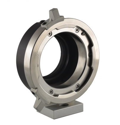

Here's three from C7 Adapters from lowest price to highest price.
https://c7adapters.com/en/product/pl..._rf__light/260
Price
$255.00
Main features:
  • Weight ( without PL cap) - only 160g / 5.6 oz
  • Adjustable flange focal distance (shims available here)
  • 0,005mm accuracy
  • Infinity focusing
  • Made of aircraft grade alloy
  • Black anodized
  • Made in UE
Compatible with:
  • Canon EOS R
  • Canon EOS RP
  • Canon EOS R5, R6
  • Canon Eos C70
  • RED Komodo
  • RED V-Raptor
https://c7adapters.com/en/product/pl...red_komodo/268
Price $367.20
Main features:
  • Stainless steel PL mount flange
  • Support foot with 1/4" mounting point
  • 0,005mm accuracy
  • Infinity focusing
  • Made of aircraft grade alloy and stainless steel
  • Black/silver anodized
  • Made in UE
  • Weight ( without PL cap) - 376 g / 13.3 oz
Compatible with:
  • Canon EOS R, RP
  • Canon EOS R5, R6
  • Canon Eos C70
  • RED Komodo
  • RED V-Raptor
https://c7adapters.com/en/product/pl_mount_-_komodo/270
Price $612.00
Main features:
  • Stainless steel PL mount flange, RF-mount bayonet and PL locking ring
  • 0,005mm accuracy
  • Infinity focusing
  • Weight ( without PL cap) - 450 g / 15.9 oz
  • Made in UE
Compatible with:
  • Canon EOS R
  • Canon EOS RP
  • Canon EOS R5, R6, R3
  • Canon Eos C70
  • RED Komodo
  • RED V-Raptor

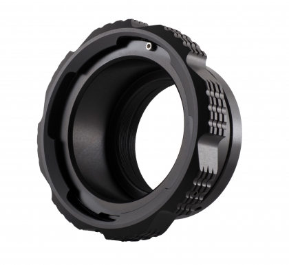

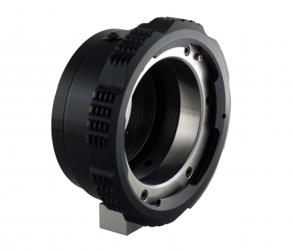

Heres the Tilta RF PL mount I received today. Seems pretty solid and Im planning on keeping it as its as solid as any other one PL adaptor Ive had in the past years. And I like the 2 thumb levers to let you know where the mount is and to really make sure its tight if needed.
I gave it a few light pushes and pulls on the end of the lens to make sure it would not wiggle under minimal effort and it held pretty good with no lens support attached.
Never mind the not correct rails setup Im still waiting to get some parts to get the proper lens height. Any suggestions welcome..
The one thing Im not sure on is if this mount can be shimmed if needed for some lenses that might not focus on infinity or the focus scale is off.
. Just now need to get the little support that will 1/4 20 on to the front of the lens and the bottom of the PL mount.
The flocking or internal black paint is or seems like its not as dark as I have seen on other adaptors but maybe its designed to work with this type of mount.
At any rate it seems pretty solid and easy to put on the camera so it ticks the boxes I need and wasn't that expensive.
I did buy it direct from Tilta though.
