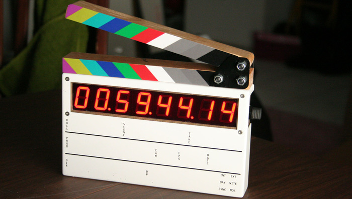

In the meanwhile, the website has also been redesigned with what you can expect from us after the campaign. http://www.fuzeti.com/ The new slate has been redesign and improved based on feedback from those who have used the first slate. The new timecode generator can be used by itself or coupled with clapper and panel. It is also designed to lower tooling cost and initial fund down to just $34,000 to get everything made. For our Kickstarter, one complete slate will start at $600.00 USD and standalone display generator at $450. After the campaign is complete the retail price will become $699.99 USD and $499.99 respectively.
Features:
- Timecode generator supports frame rates of: 23.976, 24, 25, 29.97, 29.97DF, 30, and 30DF
- Drift between devices is less than one frame (~35ms) every 24 hours
- Sync from other timecode devices (Runs on internal clock after jamming)
- Jam or run off of an external timecode generator
- Worry free rain or shine with Water Resistance (IP 55)
- Standard 5-pin timecode input/output
- 1/4" TRS timecode input/output
- Easy to adjust display brightness knob
- 16 hour run time with display continuously lit on maximum with 4 AA batteries (Batteries not included), or run indefinitely off of an external power source DC 5-16V.
- Display can be removed from panel and clapper for standalone operation.
- Solid wood clapper sticks makes a clear and sharp snap.
- Solid and sturdy construction. The front panel is made of steel and powder-coated with white dry-erasable surface.
Display only: 8.5"W x 2.1"H x 1.75"D, 12oz
Display with Panel: 8.5"W x 6.5"H x 1.5"D, 33oz
Extra sealing upgrade will allow you to take the display into shallow waters. Included will be a sealing cap for the 5-pin Lemo port. We won't be able to test up to IP66 rating with 3D printed parts, so final rating will not be available until production models are made.
BNC available as a post-production mod, this option will not be weatherproof.

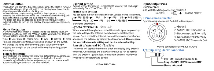

There will be a quick reference card on the back of every panel.

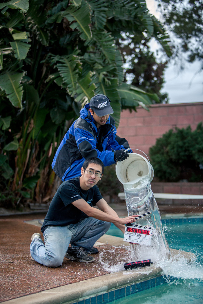

Testing the new timecode generator display in a bucket of water. Behind the unit you will see a metal plate screwed in to keep it from floating up to the top. Sorry about the shaky video:-P The display will come weather proof (IP 55) as standard, and with more testing we should be able to offer a waterproof option as an upgrade.
Thanks and have fun!
