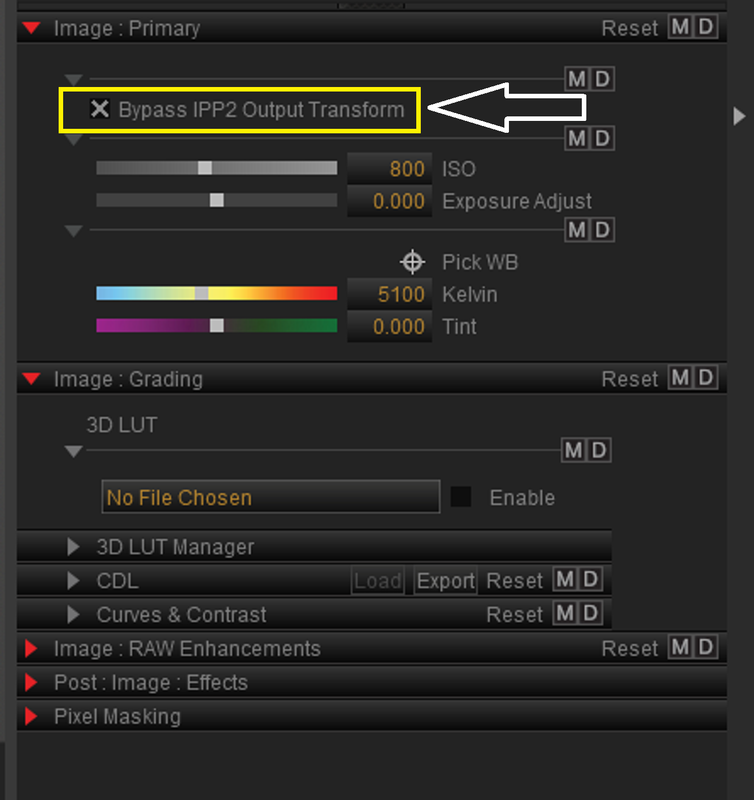

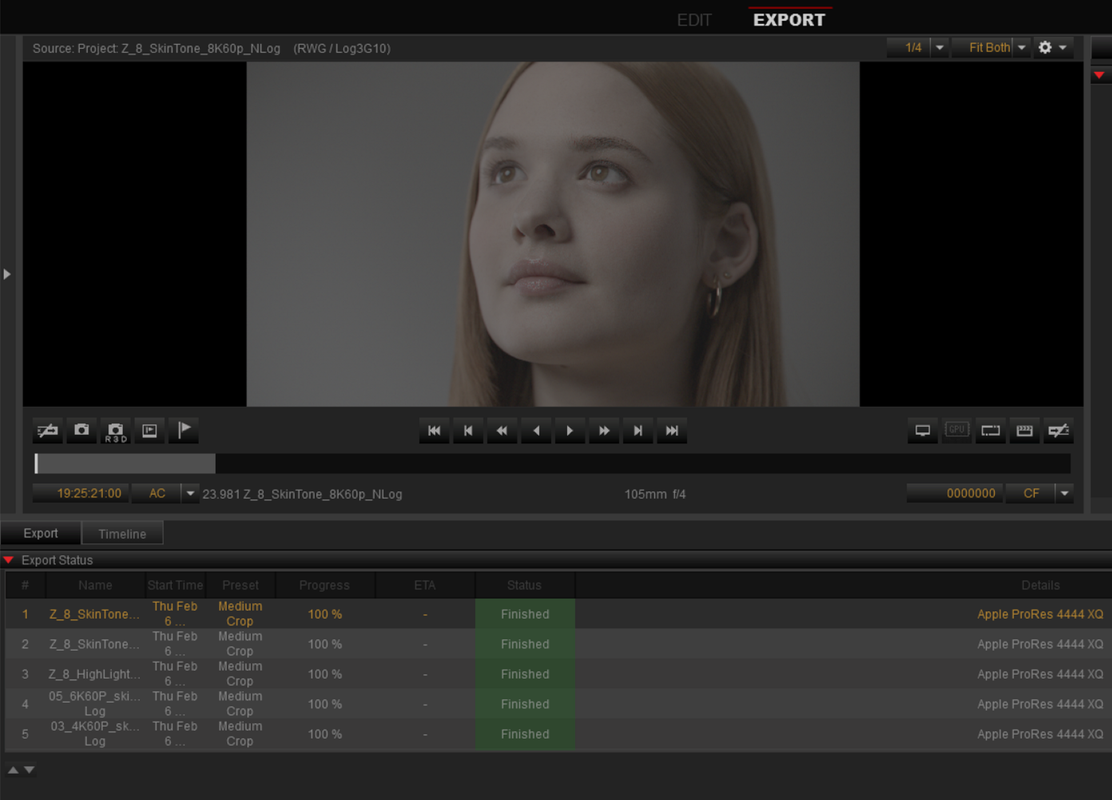

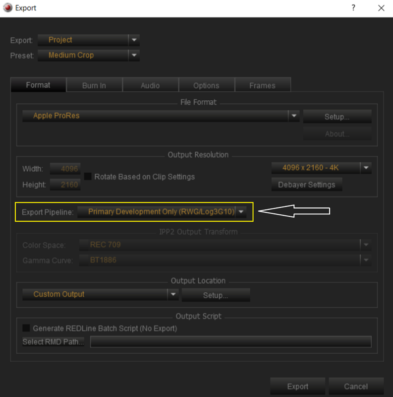

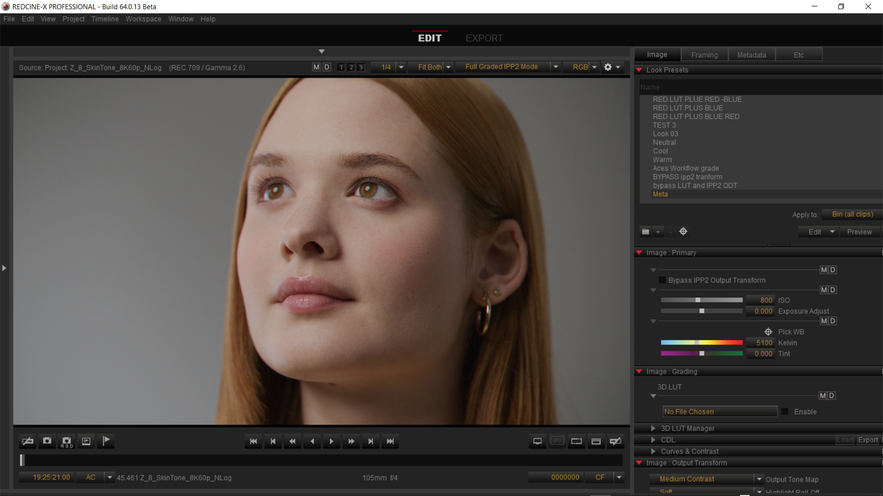

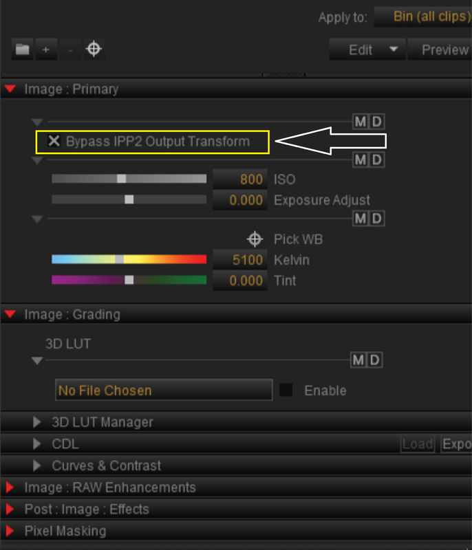

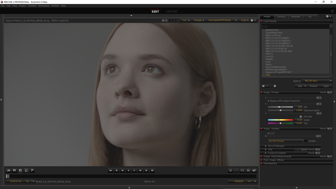

I took a NIKON .NEV Raw file into REDCINE-X 64.0.13 and exported it with a "BYPASSED IPP2 OUTPUT TRANSFORM" so that the image would be in the RWG/LOG3G10 COLOR SPACE and I chose to make it a PRORES 4444 XQ file. The Clip now needed a RWG/LOG3G10 IDT inside of an ACES PROJECT COLOR MANAGED WORKFLOW instead of the REC2020/ N-LOG IDT as prescribed by NIKON. I had to adjust the EXPOSURE by a HALF of a STOP because it looked a little under-exposed in relation to the original .Nev file and I increased the SATURATION from 50 to 57.

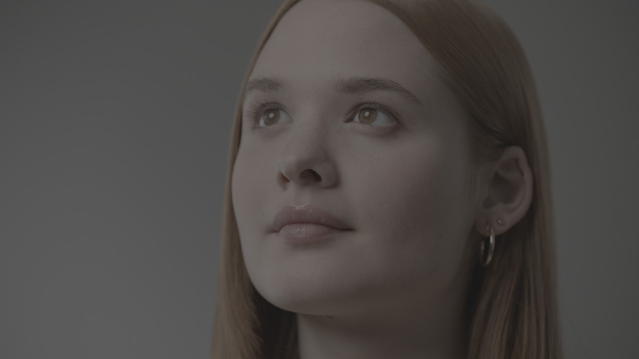

ORIGINAL IMAGE IN PRORES with RWG/LOG3G10 IDT

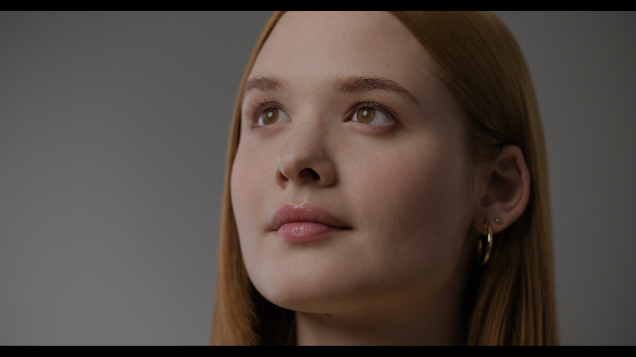

ORIGINAL NIKON. NEV RAW image with AUTO IDT for NIKON RAW File.
PRORES RWG/LOG3G10 Image with a HALF A STOP LIGHT INCREASE and SATURATION of "57"

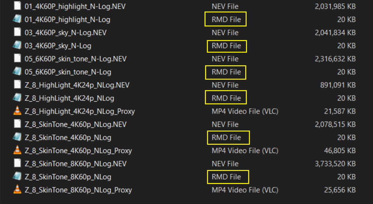

Also once you bring the NIKON .NEV RAW file into REDCINE-X, it attaches a .RMD file to the NIKON .NEV file of any corrections you made in REDCINE-X.

First in REDCINE-X you can "BYPASS IPP2 OUTPUT TRANSFORM" or in the EXPORT SETTINGS, use "PRIMARY DEVELOPMENT ONLY(RWG/LOG3G10" to export an APPLE PRORES file in the LOG RWG/LOG3G10 Format.

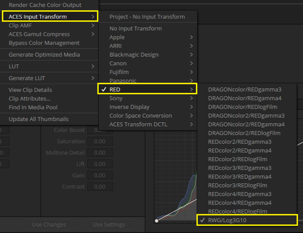

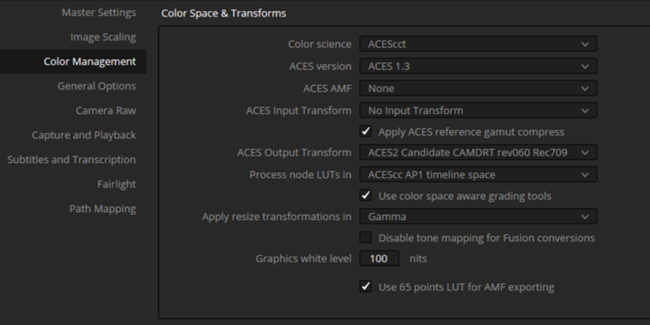

NEXT AN ACES COLOR MANAGED WORKFLOW IN DAVINCI RESOLVE

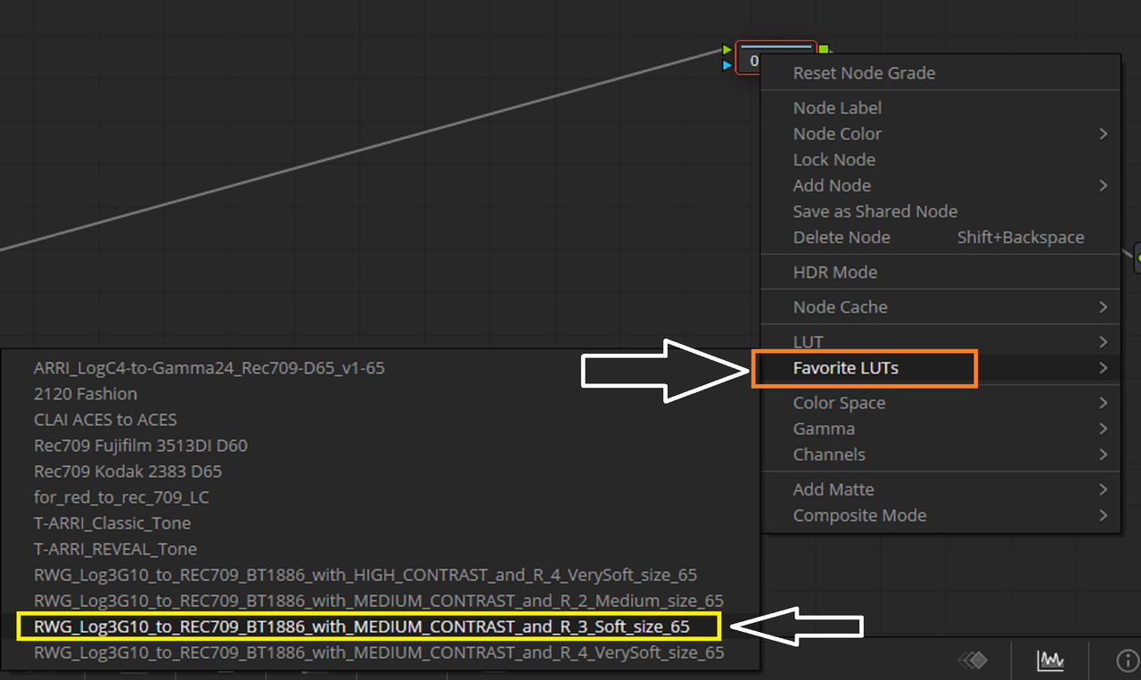

A NODE BASED WORKFLOW IN DAVINCI RESOLVE WITH AN IPP2 OUTPUT TRANSFORM LUT AT THE END OF THE NODE TREE.

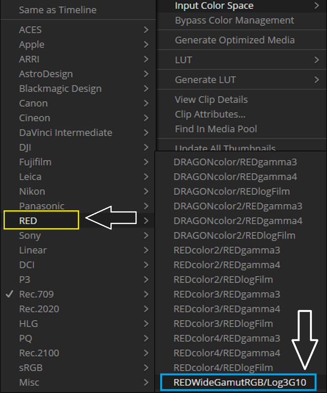

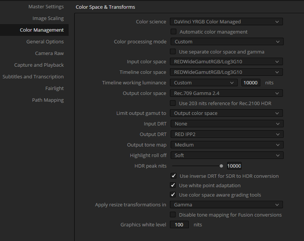

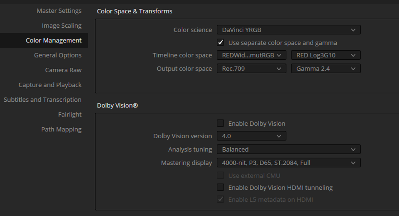

And a REDWIDEGAMUTRGB/LOG3G10 COLOR MANAGED WORKFLOW in DAVINCI RESOLVE
