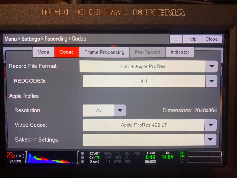

I am having a reoccurring issue with my MONSTRO. For whatever reason the option to bake in the LUT into the proxies keeps getting disabled. I simply blanks out the options and saves a LOG3G10 Proxy by default. The only way to get the button back is to reset the camera. Oddly the moment I shut down the camera I lose the button again.
The camera just returned from a service at RED and I thought it was fixed but just a couple weeks later the issue just showed up again.
Obviously I tried all the usuals: reset, full wipe, FW reinstall. Did not try to downgrade FW.
Here is a picture of what the screen looks like.
Has anybody else experienced this?
Thanks!
Tim
