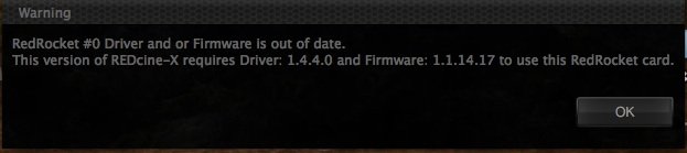

RCX 356 and RedRocket
I think you should go here: https://www.red.com/support and download the actual driver and firmware. First install the driver and after that flashing the actual firmware to the rocket. After flashing the rocket make a cold restart (power down system).
