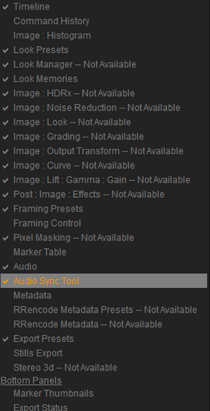

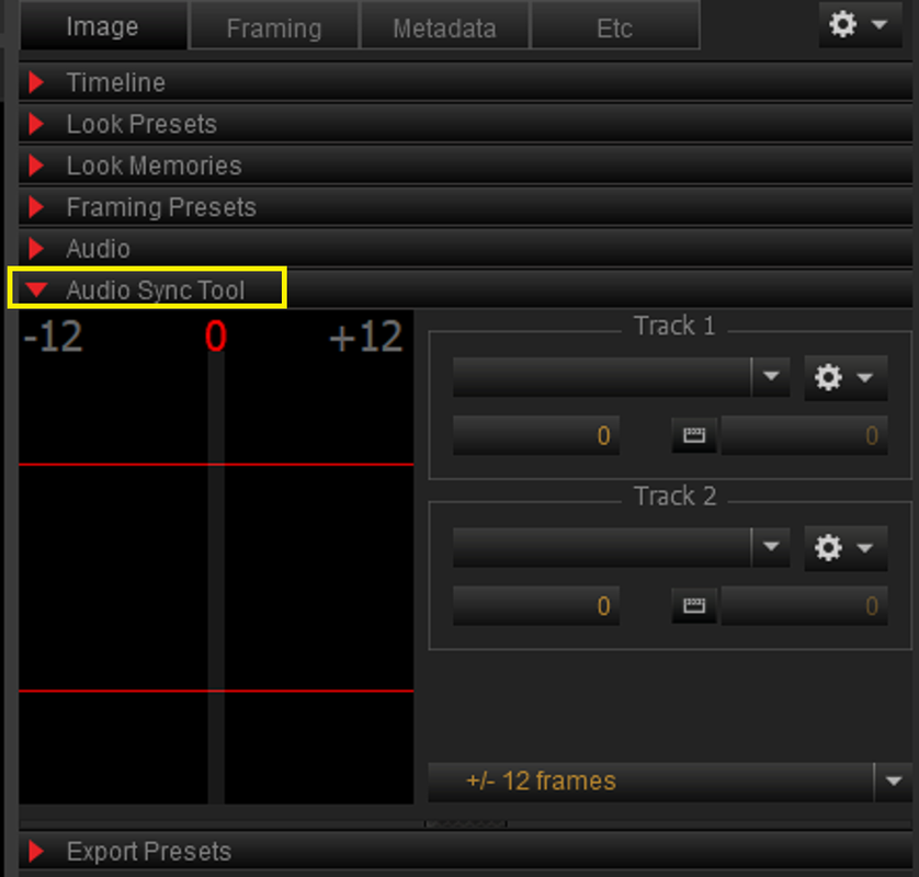

I never had to use it myself but if you "Right-Click" in the "Panels" area there is a tool called "Audio Sync Tool" if you've not already tried it. Maybe that could help

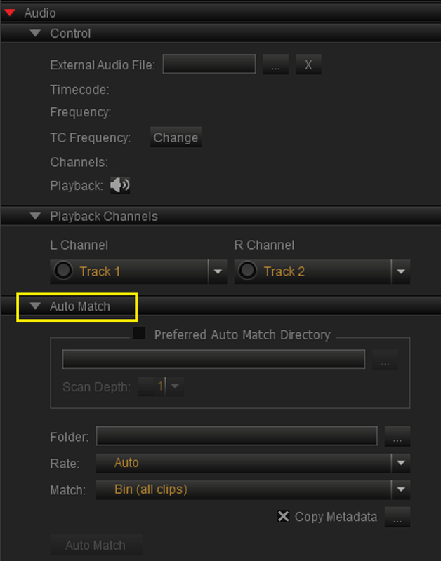

Did you also try "Auto Match" in the "Audio" area
