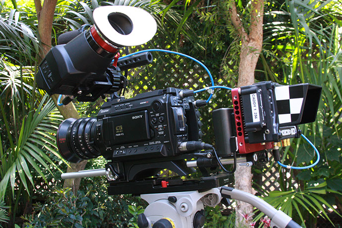

Check out my solution for mounting the Pix240 on an F3. (This same solution works great on other cameras including Scarlet & Epic.)
I created a Custom cheeseplate called ENDURO POWER for the PIX that replace the entire back of the PIX . On my cheese plate is either an Anton or IDX battery plate. The battery plate internally powers the PIX and allow provides power to the Sony F3.
One battery powers everything!
The ENDURO POWER has over 20 mounting points in 1/4-20 & 3/8-16. The hole spacing is industry standard, and conforms to 9mm spacing increments.
My favorite setup for the Sony F3 is with an Element/Technica base plate with rear rods. On the bottom of my bracket I attach a x rod adapter and the PIX240 securly attaches.
