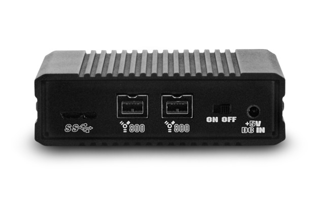

Soon-to-be R1 MX owner here. I'm trying to understand the older ecosystem of this camera. I've done some research on my own but I've hit a dead end. I was hoping that someone with knowledge of this system could help me out a little.
It seems that there was more than one Red Station SSD reader.
Variation #1 has fewer slots: "SS" (USB 2?), 2x Firewire 800, a power switch, and a 5V DC input.
Variation #2 has more: two power "slots", eSATA, 2x Firewire 800, USB 2.0, a power switch, and a 5V DC input.
I suspect that Variation #2 was designed to be daisychained to a Red Base and CF reader, whereas Variation #1 was standalone. Is there any reason that #2 can't be used as a standalone? eSATA might be a faster way to offload footage, using a cable adapter like this. Right?
And lastly, my understanding is that Red Mini-Mags are the newer, more compact versions of these cards available for the DSMC 2 bodies. But, I see a lot of people referring to the older 1.8 SSDs as Mini Mags. Which is correct?
Pretty sure the standard jargon for the older, larger recording media was "Redmags" and not mini-mags. The newer, smaller version, are indeed, called "Mini-Mags."
As for the readers you show above, I have both and use them interchangeably depending only on what cables and connectors are available. Of course, these connectors are old types as far as modern computer connections are concerned; i.e. to my knowledge Apple hasn't manufactured a computer with Firewire in several years.
Thanks for the info, Terry. That is helpful. You're right, I haven't used anything with FW800 in 5+ years. I'm going to go the eSATA route for my purposes.
There is another USB 3.0 version which I find more useful. I have the one you call v2 if you are looking to buy.
Interesting. I just pulled the trigger on the second variation, but the 3.0 would have been nice to have. What did the connector/port look like on that one?
The first one is a USB 3.0 version, while the second one is USB 2.0/E-SATA. I don't know anyone actually using firewire nowadays, but I have them both and usually go with the #1 for on-set purposes (it's much smaller and lighter), while a have multiple #2 on my workstation - to offload media at home. E-Sata is as fast, as USB 3.0 (bottleneck is in the drives anyways), the #1 are harder to find, the #2 are an easy buy.
#1 powers through USB, while #2 also powers through usb, but when you're using E-sata you have to power it through DC-in. It does come with plenty of options to power though (DC-in to usb power cable, power input, cables to daisy-chain power and so on). Talk to seller on cables on #2.
