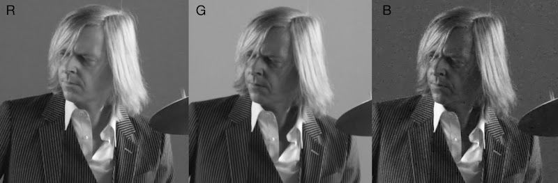

Noisy Blue channel using Build 30
Pietro I agree, artifacts is definitely a more appropriate term. Multi-pixel patches both lighter and darker than the surrounding data. I'm very surprised that this issue isn't more talked about, if its happening on all M-sensor cameras with build 30... I'll just have to wait and see what Red say re: my support ticket, but no news yet.
One thing's for sure, if this were a grab from any other camera, this community wouldn't be giving it an easy time ;)

Isnt it lovely? Here is our blue channel
firmware 30.5.0#30
I am concerned, and would like to hear an answer from RED.
I noted the same issues on a Build 30 camera, and the issue is not present on build 17 and 21, with the same camera.
I can happily shoot 21, or even 17 on this camera for now.
I'd also love to hear if a user or RED has confirmed that this is not an issue on Red MX cameras.
The advantage - exposure and camerawise - of shooting 30 over any other build is immense.

Remember. Channel peaking is only good to look under the hood. An image consists most often of 3 channels, and that's the image we need to be happy or unhappy with...
All in all I am very happy with B30. Both for set and post.
And for those special occations, I'd rather go pre 21...
I disagree...
images are the summation of the three channels, and looking at individual channels is important for lots of different types of work.
For example, what if I am trying to key a sky? That's a common enough situation. What if I am doing a Levi's commercial and have to super saturate some blue jeans?
What if I am doing a fashion shoot and want to push purple?
What if I am doing a super blue look, perhaps as part of day for night, or just because I want a very cool look to my footage.
Looking at my compositing work, what if I am keying on a color separated channel- say a blue screen?
No, this is a huge issue.
This is a gap of some sort of a gap in the image data, and I can only assume its an artifact of the new software, because again the camera works fine with other builds. (It doesn't matter by the way which build of software I work with in post, just the camera firmware. Is that consistent with other users?)

All I know is that what I thought I was looking at is not consistent with what you are describing.
That said, what you are describing makes sense, so I need to redo my tests.
Frak.
Well...
The problems you see is from FLUT/B30 post, not B30 shooting.
These are "FLUT color science" post arttefacts...
How is this right when I can get an artifact free blue channel shooting build 21 and using the latest RCX to process?
I've tried everything to make it go away under b30, including your suggested technique of dropping the exposure or ISO and boosting afterwards, but it really makes no difference. I'm still left with a blue channel I really can't push much, as the shadows are full of little black holes.
I'm surprised nobody from Red has chipped in here, even if its just to say 'Yes they all do that sir, use b21' :violin:

I noticed this "speckling" a couple of weeks ago when preparing for a music video shoot. Back then I thought the footage was simply extremely noisy because I was lighting the dark test shoot with Tungsten lights without blue gels. This thread explains what was actually happening; thank you Mr. Marchant for raising this issue.
I look forward to installing the new beta and checking whether the speckling is gone, or severely reduced, at the very least.
