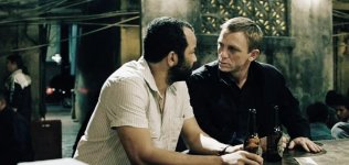

Hi Redcine. user .Please help me...
I need this Look(attach one pic) Redcine-x RMD Look file,,
please
thank you
LOL (sorry, do not mean to be rude...)
You will not find a RCX "instant bond" lookfile, and if you did... It would only work on images exposed exactly like thisone.
And RCX is not really for grades like these.
You could however...
Start off with redgamma 2 (or redlogfilm)
Adjust contrast curves ballparky (but not too hard)
Check the channel curves, and I would sugest that you pulled the red channel down a bit in the bottom...
THEN add a bit of alchemy (to your taste) and finally adjust overall saturation with the LAST saturation controll.
That would get you quite some way with a daylight image like this...
Then possibly add a little bit of grain... Just to make the image breathe a bit.
Cheers
G

Hi Gunleik, I agree, but I think that even when the image wasn't exposed that way, remember too that ISO is only metadata, and you can always tweak a little in RCX.. I could be wrong..
The consequence of metadatachanges (like ISO/WB) have very non-meta consequences... ;)
I just suggest what I would have tested first.
How about a LUT?.. I just made one.. Doesn't work for RCX thou.. Works for Resove, AF, Premiere, etc.. let me know if you like it..
