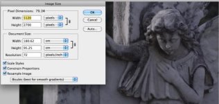

... why do I need a stills camera again?

I think in many case you'll be right, but 72dpi ain't that big.
The thing that excites me (assuming that Epic in stills mode doesn't do 300dpi) is that I'll just need to have a stills body in the bag for the really high rez stuff and, with a Canon or Nikon mount on the Epic, just chuck a lens on and shoot. No need for a whole other kit.
And that's assuming the above - not a sure thing at this stage. I mean, Jim's busy building the camera without the, "If it only had ..." clause.
5120x2700 is 71.11" x 37.5" @ 72dpi. That is the same as 17.06" x 9" @ 300dpi.

... 5120 x 2700 pixels = 13.8 megapixels which is similar to "last generation" high end 35mm format dSLRs, and "last but one" generation medium format backs. Plenty enough for reproduction in books and magazines (especially for double page spreads with the wider sensor aspect ratio). I've had published magazine covers with similar pixel counts.
It doesn't really compete with current generation medium format backs (which start at around 40 megapixels and go up to 80 megapixels) but for a great number of uses it will do just fine.
Reading it out fast enough to pull RAW-like information off the sensor and onto card at movie-style frame rates is a massive, massive achievement. My Hassleblad medium format back manages about one frame per second! Everything is a slave to that data rate and the sacrificed colour science, even more than the resolution, is the thing which has limited the use of video cameras for stills for the most part. Great to see that RED may have that licked.
Of course, as dSLR video shooters have found, the ergonomic requirements of shooting stills and shooting movies are different. It is handy to have the option of doing both in a single camera, but probably you'll end up wanting a dedicated stills camera as well just for ergonomic reasons (a 5DII with L-series zoom won't break the bank or your gear bags).
