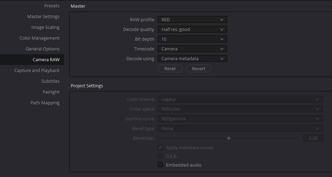

Dumb question but I can’t figure it out. Trying to use a LUT for log but I can’t get it to work. Using a Monstro Ranger.
- The LUT works with output color space Rec709 on IPP2, but it creates a double lut.
- I change output color on IPP2 to REDWideGamutRGB, none of the LUTs work.
- I switch to Legacy, REDWideGamutRGB and Log3G10, none of the LUTs work.
What am I missing?

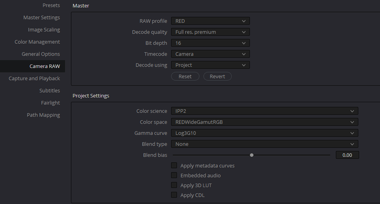

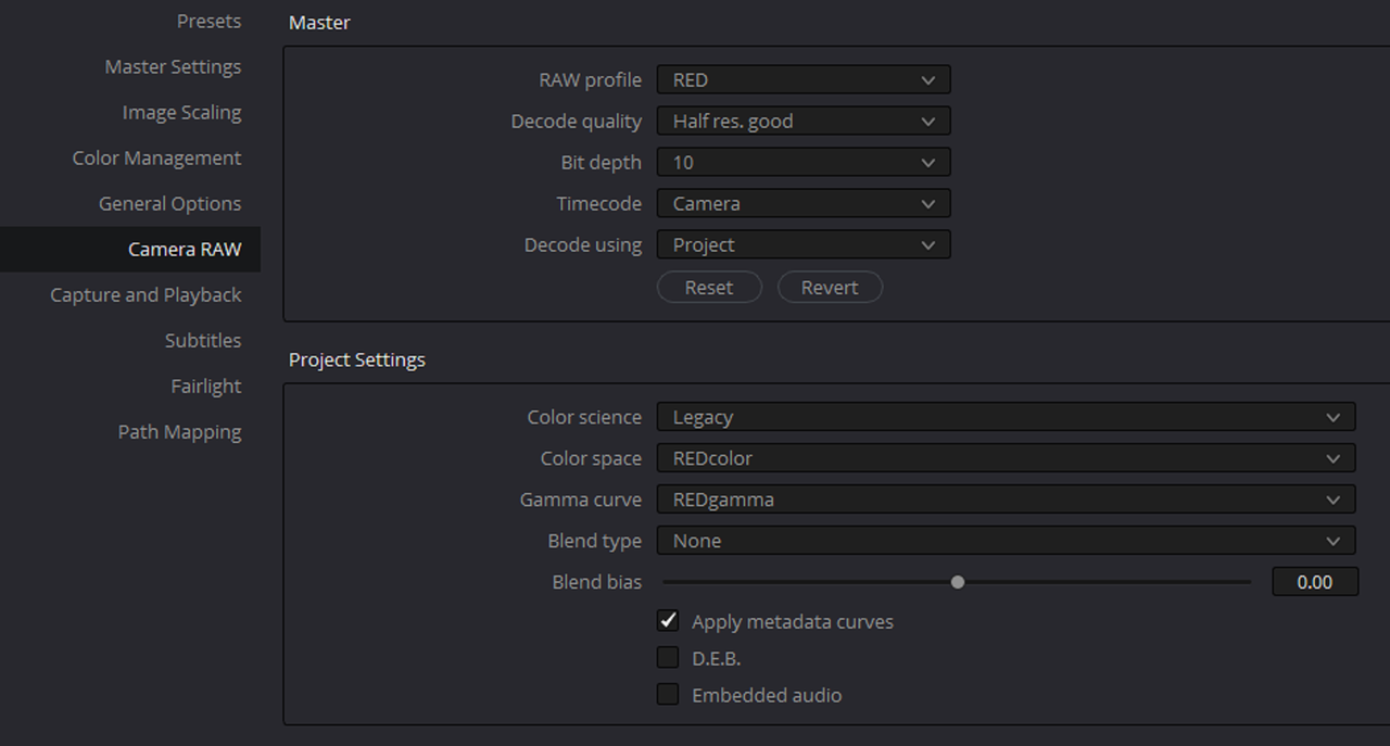

Evan,
I think it's your "PROJECT" "RED-CAMERA RAW SETTINGS"
When you start a New Project in Resolve, These are your default Camera Raw settings.
Change them to these in the Project and not for The Camera Raw "CLIP"

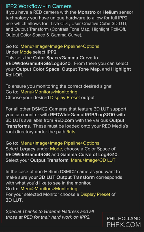

Evan,
Alright, I don't own a RED Camera but here are some instructions from Phil
