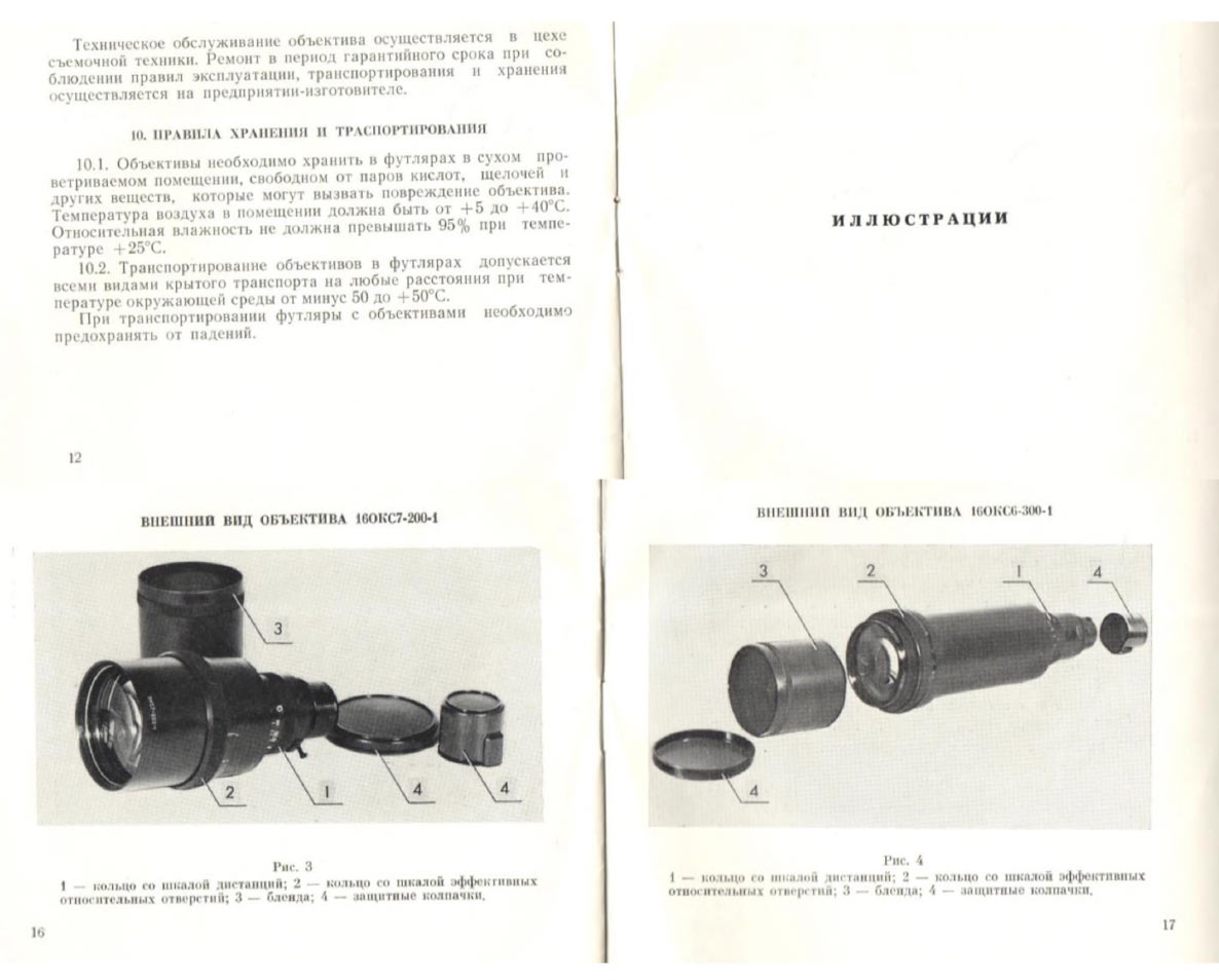

Here is late 16mm OKS lenses Manual with some tech details.
It has info on:
oks1-6-1 6mm (5.9mm) f1.8
oks9-150-1 150mm f2.7
oks7-200-1 200mm f2.8
oks6-300-1 300mm f3.5
It has OCR'ed text layer in Russian, if you are lucky and ocr is fine you can g-translate some info.

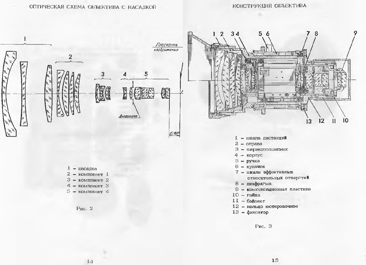

page sample:
XKuGM0
To finish up with the late design 16mm ussr lineup, here is Manual for nice and sharp
KMZ zoom lens, 16OPF12-1 10-100mm f2.5 (8-75mm with huge 0.75 wide-angle front attachment)
the link: https://goo.gl/qzYAHY
page sample:
0qU14P
