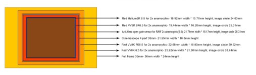

Hi, this is a chart I prepared to see the difference in the anamorphic sensor sizes of the two main cameras that are used to shoot feature films in India in comparison to 35mm cinemascope.
Thanks for doing this - super helpful!
Can you also add VV Ana sensor on that list please?
Hi, the 8K VV ANA sensor size is the same as the 8K VV sensor in the height, the only difference being in the width of the sensor size.
The 8K VV sensor size is 40.96 mm x 21.60 mm (Diagonal: 46.31 mm), the 6:5 sensor area used for 2x anamorphic is 25.92 mm x 21.60 mm (Diagonal: 33.74 mm)
The 8K VV ANA sensor size is 33.60 mm x 21.60 mm (Diagonal: 39.94 mm), the 6:5 sensor area used for 2x anamorphic is 25.92 mm x 21.60 mm (Diagonal: 33.74 mm)
