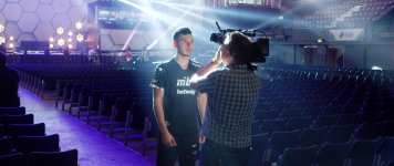

I used a carbon 1 with gemini on a job for a few weeks in october. I think its a great pairing especially with gemini. I was mostly interested in the skin tone rendering but there is a very subtle blooming. I would say the carbon 1 effect is even more subtle than a 1/8 bpm in terms of softening but it renders color very differently than the standard OLPF. Not sure how the carbon 2 compares. I attached the only shot from that shoot I have sitting around right now.

That's hard to say really. I was shooting in a very uncontrolled environment and felt like I actually gained sensitivity over the standard OLPF but that could have been the result of the subtle blooming lifting the shadows as there were a lot of hard direct lights hitting the lens.
