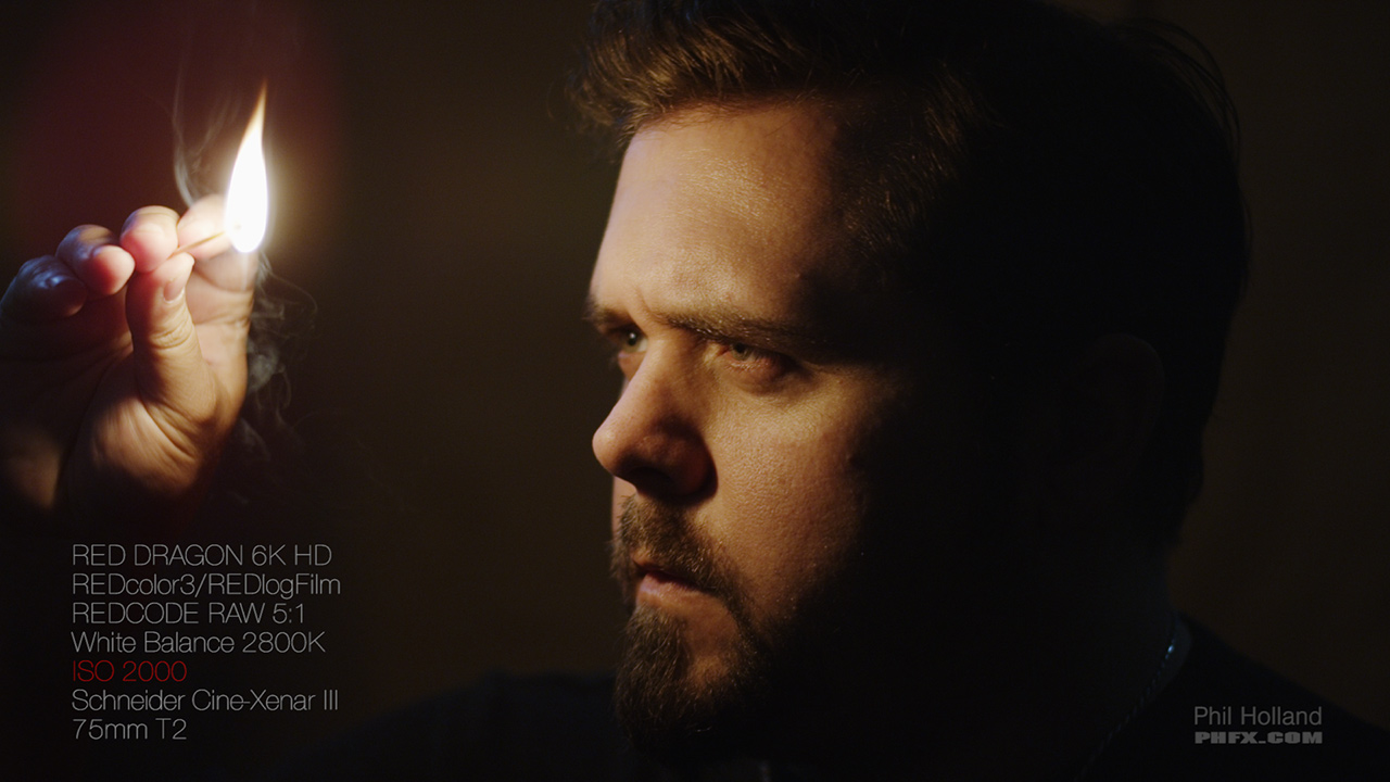

Still looks clean for 2000ISO (and keep in mind it's RAW and doesn't use on board noise reduction). By judging the images without a direct comparison, I'd say from past experience this looks like ISO 800 noise on MX. Obviously a direct comparison would help support or disprove that hypothesis... Thanks for the samples Marc.
I'm curious to see a comparison of Dragon + Neat Video vs. Canon C500 at 3200ISO and see how they compare. That would be interesting to see. Obviously, Dragon would need to be down sampled to 4k to match the C500. I'm very curious to see this...
The only thing I have been disappointed by is the OLPF flare from Dragon but since Jarred said they are already working on a fix, all is good.
I wonder if that flare would have different qualities if I put on one of our motion mounts. That said, this lens is slow at a 3.2 and the motion mount eats up over a stop.
Interestingly enough, these C500 low light shots don't look as good or as "brightly exposed" as the Dragon shots we've seen online. So much more detail in the Dragon shots and what looks like a ton more dynamic range. What's even more crazy is the Dragon shots are a single match vs. multiple candles for the C500. Skip down to the bottom for some 4K C500 candle light tests at varying ISO's. I'd venture to say that Dragon (down sampled to 4K) is cleaner at 2000ISO than the C500 at 800 ISO. What do you guys think by just looking at the samples? Again, nothing definitive without a side by side, but until then, this will help.

Dragon match/candle footage curve only, no noise reduction.
Straight Redlogfilm at 2000ISO, no corrections:

Fantastic break down Matt, thanks. Yeah Dragon's lowlight capability looks very robust. So usable at high ISOs. The c500 footage doesn't appear to have comparable range or detail (but perhaps other tests can show otherwise?).

Saw that in the other thread and thought it looked good. This thread is specifically about Dragon and it's performance in low light at 2000ISO. Some seem to think that Dragon isn't a leap in noise and sensitivity over MX, and I disagree. Thus the samples.
Holy moly these are a perfect case study of the OLPF flare problem. I hope a fix is imminent.

Definitely, but you also used more light and a faster lens than Phil's test (his blue backlight was from a bounced flashlight and shot at t2). So it's kind of hard to compare apples to apples that way. I've been looking through my old Epic MX footage and I see more noise at 800 in some of the lit stuff than the Dragon at 2000ISO.

Seems a little crazy to draw any conclusion from a comparison of those frames. Completely different kinds of light/fire at fairly different distances from the subject at totally different camera settings processed (or not processed) very differently...

Sure I can deny that. Yes there is more fill light (the Dragon ones mostly have none) but that just further complicates any direct comparison. The key side, however, could easily be 4-5 stops lower since most of the Dragon shots are unobstructed matchsticks within 3-8in from subject's face whereas the C500 shot the candle looks closer to 1ft away (could be 2-4 stops right there), and the candle flame may be partially obstructed by the candle's edge and who knows how bright or large the flame is and how it compares to the flames in the other shots. Looks like a short wick and the wick is probably partially drowned in wax... I'm not saying it is or isn't brighter or darker but with sources like that you really don't know and most likely they are not even close comparisons. Lights so dependent on what and how much is combusting at distances so small that a couple inches drops exposure several stops, it just seems a little silly to even put them next to each other.
