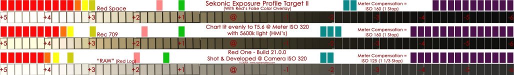

During Shawn and I's testing I also shot my Sekonic Exposure chart. After processing it it gives me values from 5 stops over to 6 stops under (That was the range of the lens and chart.) I also shot reference frames of what False Color was telling me. If you want to check out the 4k or 2k stills, or the False Color pictures you can download the file I've linked to below. I have attached the final combined chart to this post for quick viewing, but it is also in the link below.
Sample Frames and Reference Pictures: (83MB)
http://www.ryanewalters.com/downloads/ExposureTest.zip

These are some things I have noticed on build 21 with False Color, and they worry me ... (You can see this in the reference stills in the download above.)
- In all of the color spaces the false color values fluctuate by 1/6 to 1/3 of a stop and they are not consistent fluctuations.
- In RAW mode sometimes the Straw value does not come up.
- 18% Green does NOT line up between all three views like has been stated before. (It did back in a previous build - build 20 I think?)
These issues are especially troublesome since the difference in-between yellow, orange and red are 1/3 of a stop, and if False Color is not reading correctly- especially in RAW, then it is useless as a precise exposure tool.

My only question is why the False Color guidelines don't match my meter at 320 ASA. Are the False Color guidelines designed to only indicate RAW levels even when viewing in Rec 709?
