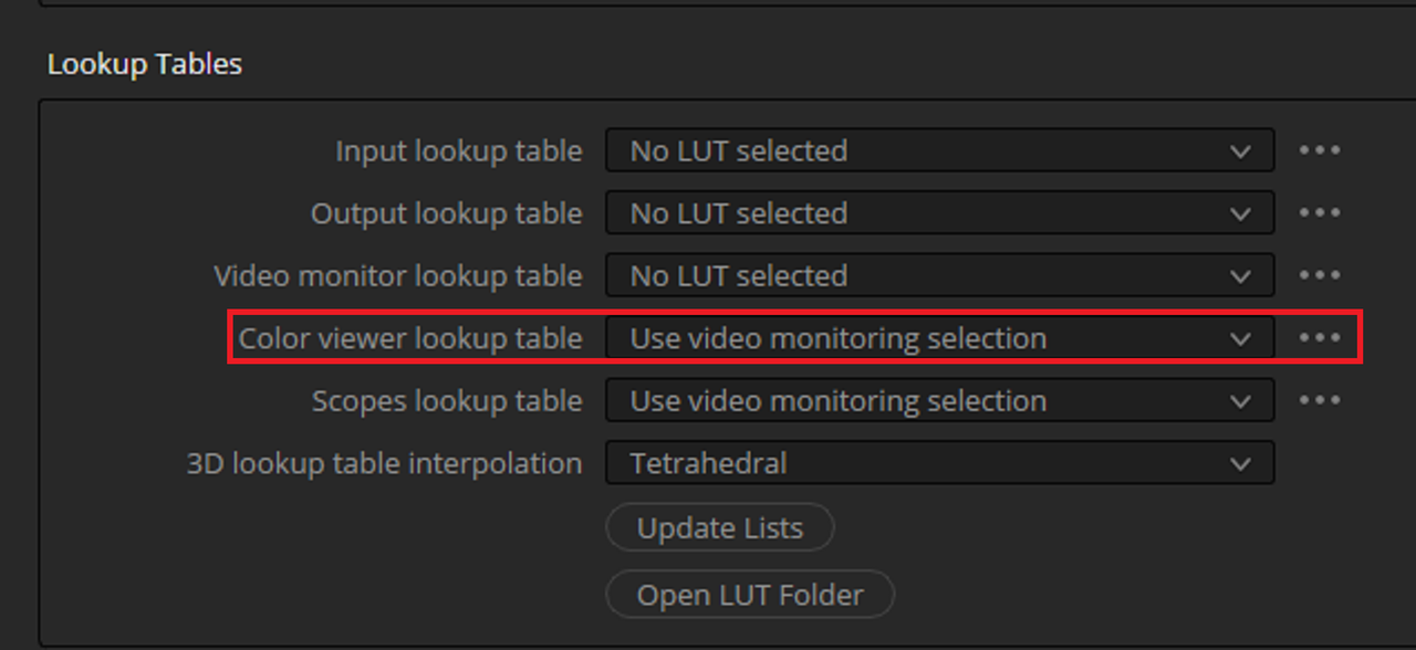

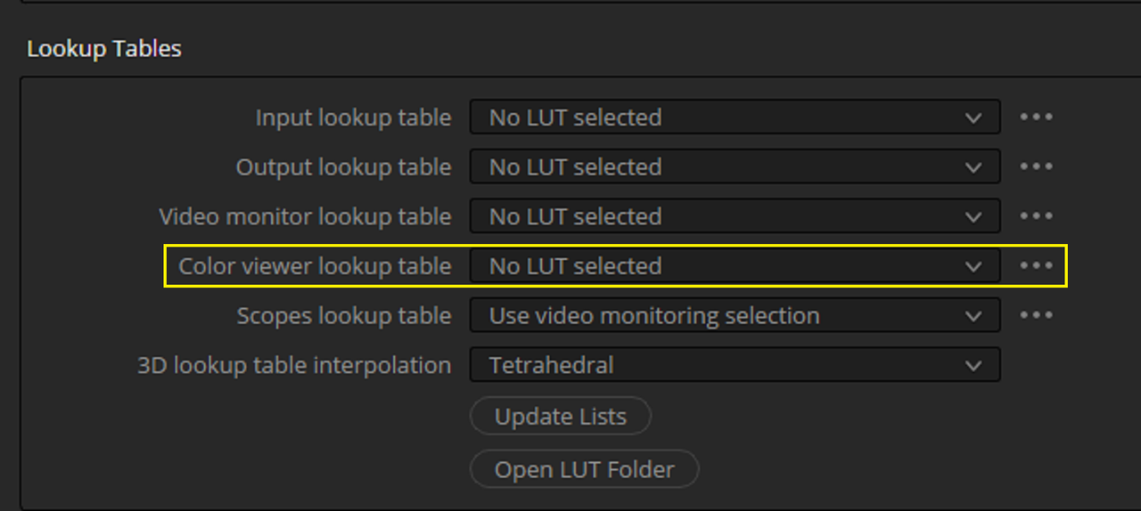

1) In the "Project settings" in the "COLOR MANAGEMENT" tab then under "LOOKUP TABLE" and "COLOR VIEWER LOOKUP TABLE" what setting do you have? If you haven't already change it from "USE VIDEO MONITORING SELECTION" to "NO LUT SELECTED". This way no Lut is affecting what should be a clean feed or something like that.

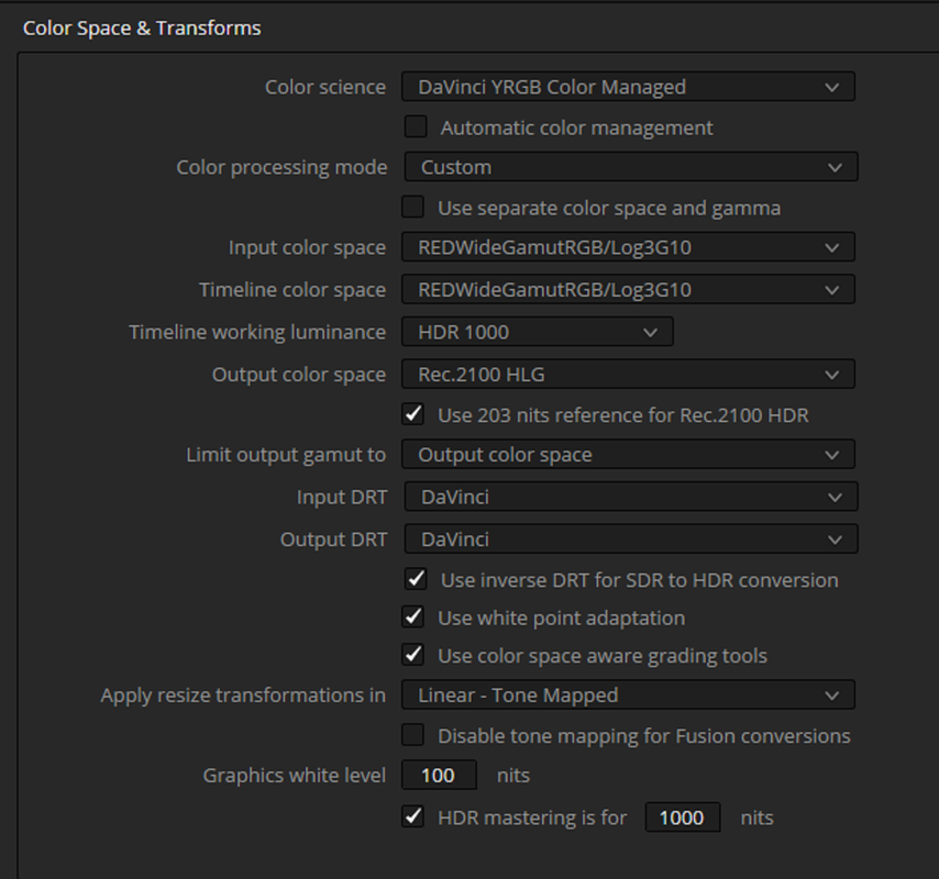

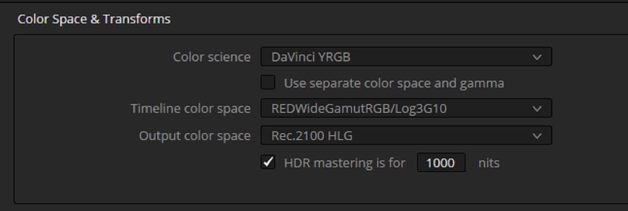

Thanks Rand, I just tried that. No luck. I've tried RCM, node-based, you name it! These were my most recent settings on the color management page. I used a CST from REDCINE X, REDWideGamutRGB/Log3G10 to Rec.2020 HLG HDR for the node-based color mgmt one. :(

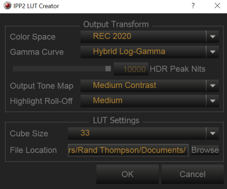

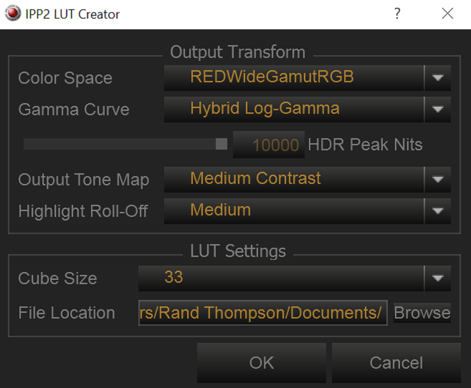

Jon give me a while to try to figure out some settings both Color Managed and Node based that we can try that may help and I will get back to you
Jon here first is the settings that I would try Color Managed first. I will try to figure out A Node Based also and post it.
Plus I don't know if you've seen this video already or not.
