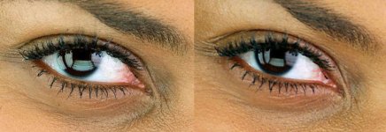

But in terms of sharpness it seems like the Hasselblad wipes the floor with the Epic
attachment.php
But there's no question it can be used with smaller prints!
attachment.php

I'm just trying to understand the reason why some would find their images less sharp while Hurley doesn't even mention it. The reason I suspect, is the OLPF and the failure of some to compensate, or allow for sharpening before making a comparison. That is why I asked you if you did or not. I assume that Hurley did. Were he involved in this discussion I would ask him too.
