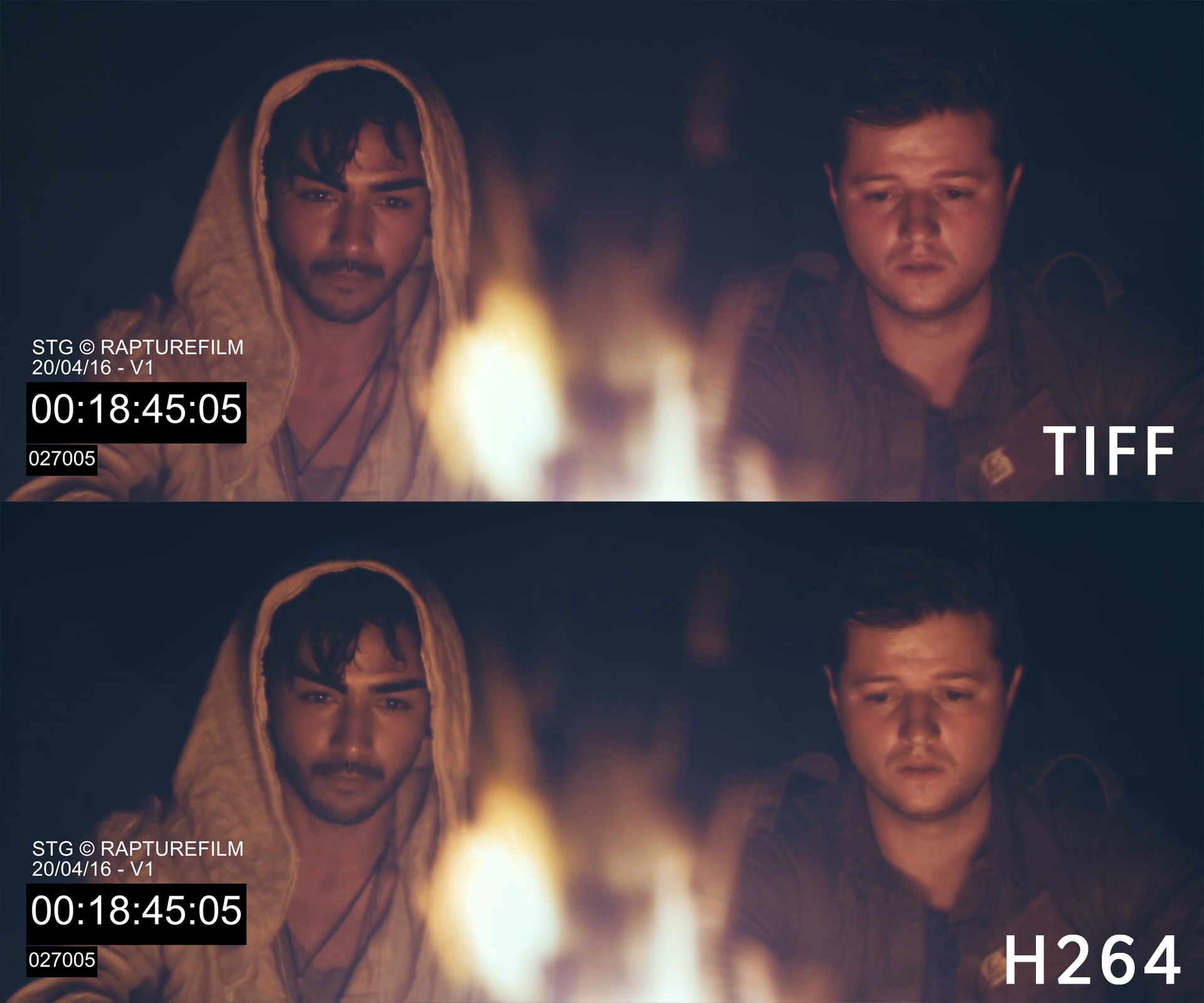

I was watching a draft of my latest project which was exported from a 4K 16bit TIFF sequence in After Effects as H264, when I thought, "Why is everybody looking so YELLOW?!" I assumed I'd accidentally added something onto the final sequence and so went looking for the problem, but found nothing.

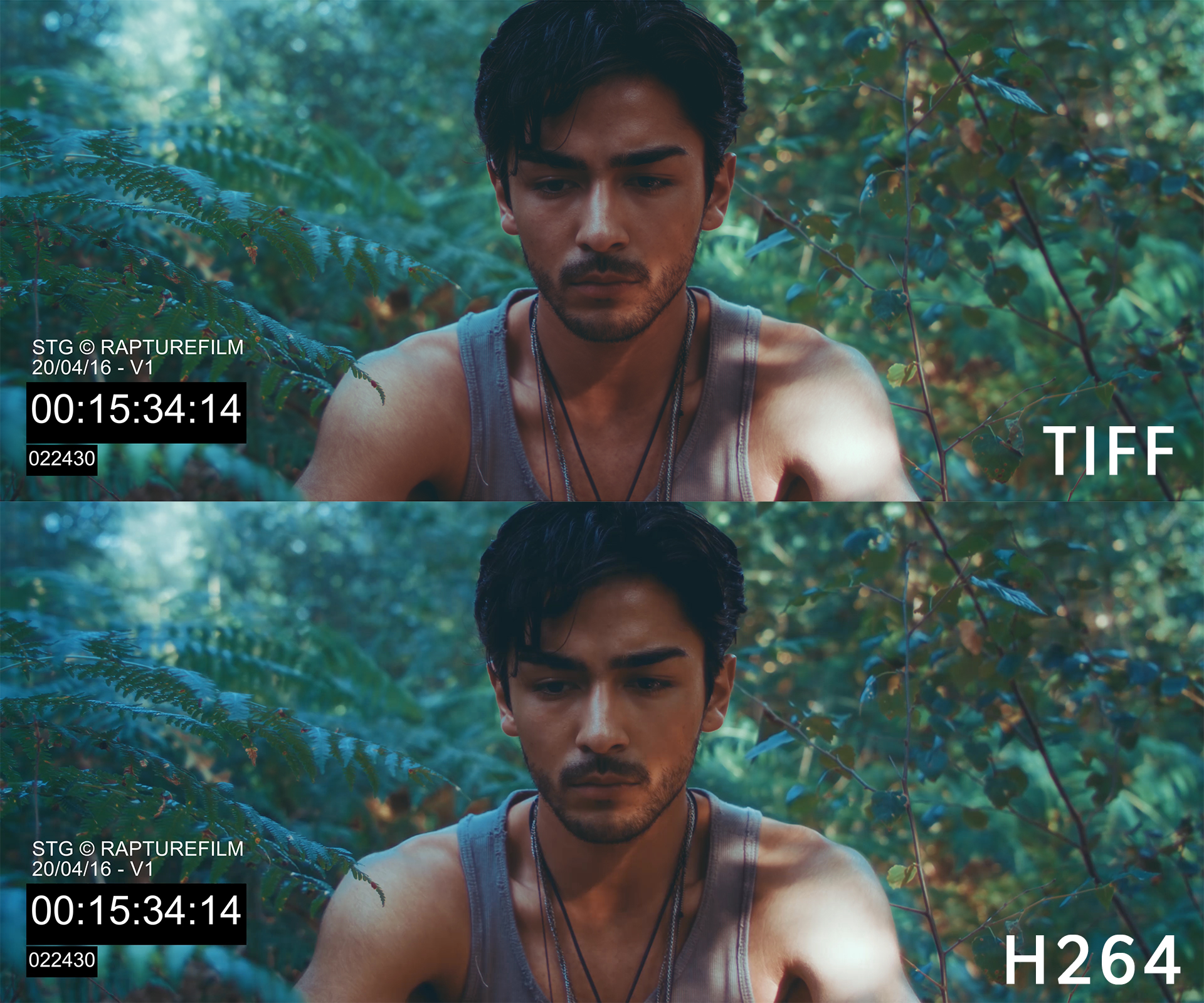

After a little testing I can confirm that the below result is occurring only when exporting H264... I've never noticed this before - Has anyone got any idea what's going on? AE 'Working Colour Space' is set to 'off', the project can be in 16b or 8b and give exactly the same result.
In particular notice the yellow skin tone and the greens being pushed towards blue, especially in the ferns on the far left.

The encoder is most likely making an assumption about the range. e.g. video vs. pc range. In 8-bit that would be 16-235 vs. 0-255. Often an encoder will assume that RGB is 0-255 and then compress it to 16-235. If your content is already in the proper range, that messes it up. It also has to color convert from RGB to YCbCr. It may not know if it should use 601, 709 or 2020 3x3 matrix.
Then you have similar options on the playback side.
Professional compressionists often use their own software to convert a 16-bit TIFF into an 8 or 10-bit YCbCr 4:2:0 so they have complete control. Then they send the encoder that directly so the encoder does not perform range compression or color conversion. This is the normal workflow for professional Blu-ray Disc encoding.

This issue does NOT occur when exporting H264 from an 8bit TIFF sequence through PREMIERE. So I guess that's a work around, but a bit of a pain as Premiere doesn't accept 16bit TIFFs. Any ideas?
I would also suggest starting with a few test frames of SMPTE color bars that you can check on a scope. This will tell you very quickly where and how things are changing. Having a reliably-calibrated monitor with a color-managed output helps a great deal. Computer displays frequently will lie to you under certain conditions.
