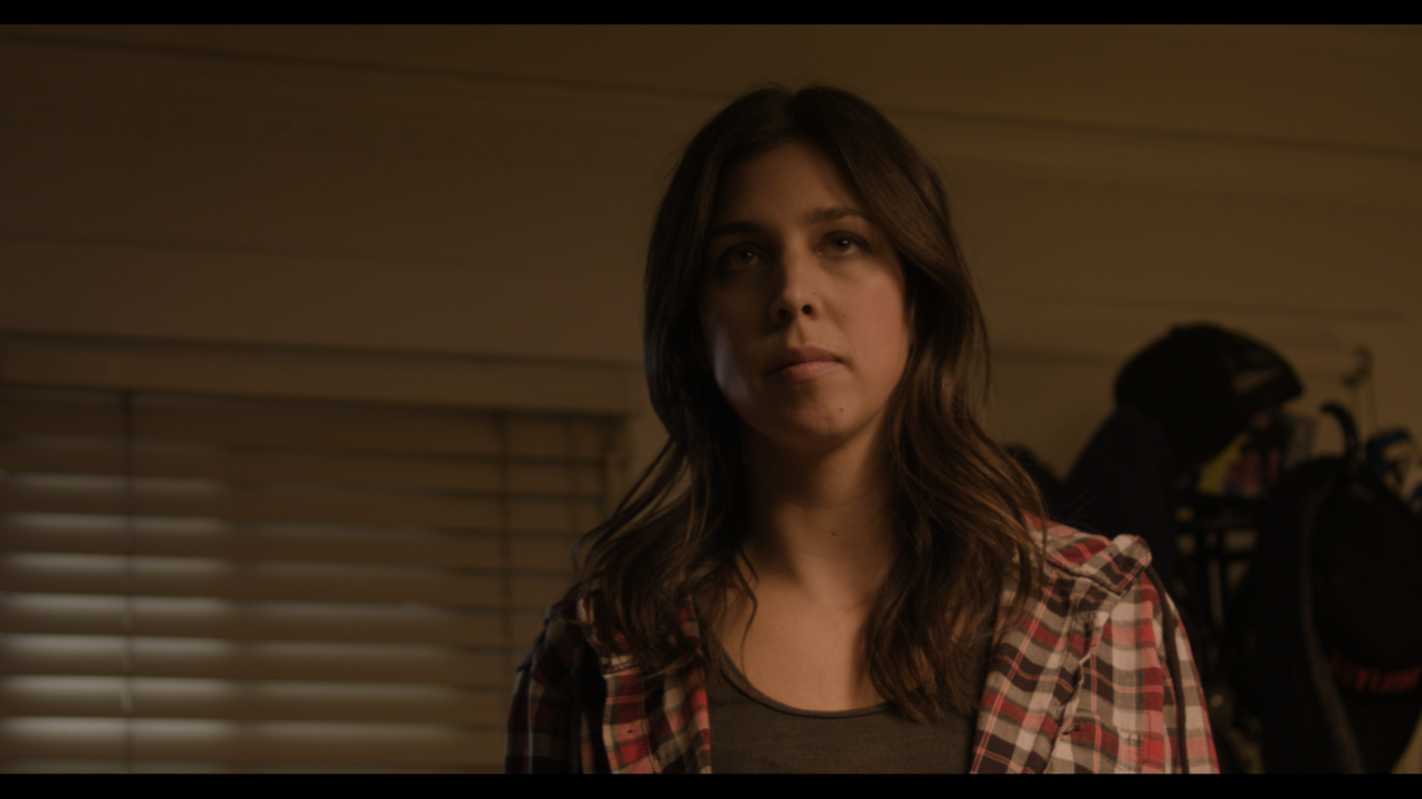

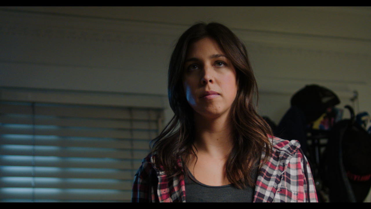

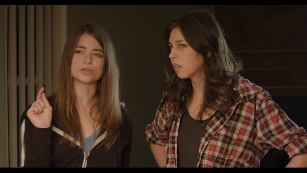

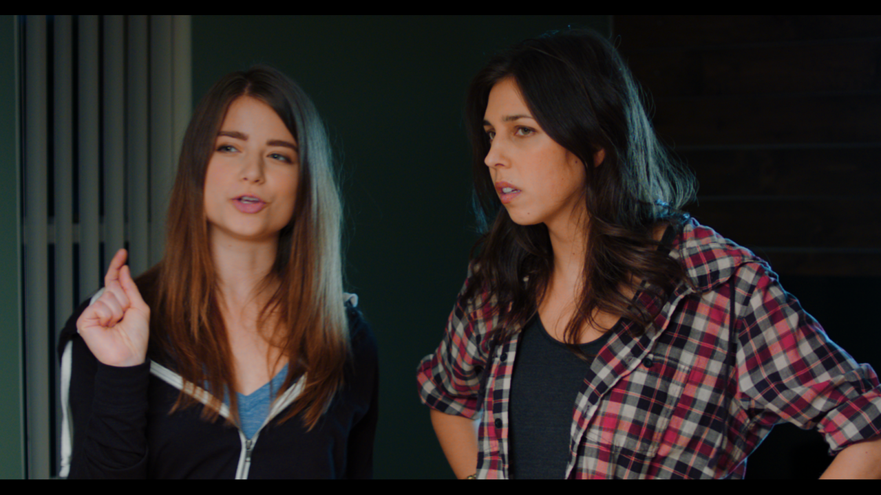

I've been trying out CLAUDE using the "SONNET 4.6" Model, I think "OPUS 4.7" might do a better job however. But it not very good with complex grading work. In the example below I use a grade that I have made that I have made for one image for CLAUDE to apply to another Image with similar lightening. I have already added the grade from the previous Image to the second image used so I know what it should look like when applied.
UNGRADED FIRST IMAGE
GRADED FIRST IMAGE
UNGRADE SECOND IMAGE
GRADED SECOND IMAGE with Same Grade as First Image. This should be how it will look if CLAUDE matched the first Image's Grade to the second image successfully
