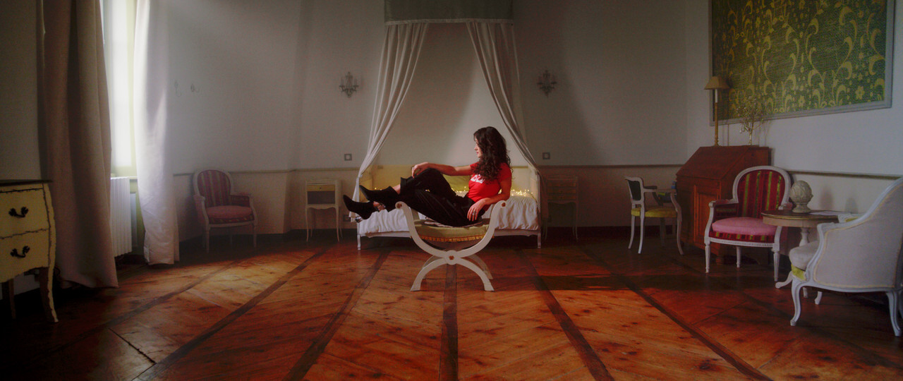

Man these look sooo good. Awesome work Aaron! The girl in the red shirt feels lowcon but you gave it depth through the color separation in there. REally great work.
Sabovic,
I love the contrast and the colors you chose to go with. I would have never thought to do this!
Sabovic,
Yeah, I gave it a little bit of mystique, I mean that's what I think I did. :rofl:
And the floor looks more wooden like this...I don't know.
Sabovic,
Yeah, I have Brazilian Cherry hardwood floors, that look about like this. The longer that Brazilian cherry wood is exposed to sunlight, the darker and more red it appears. I realize this flooring is probably NOT Brazilian Cherry and more likely than not the color I believe everyone else has displayed it to be.
I personally think my grade is probably the most destructive and goes against the original intent of adding smoke in the first place. I think I added both more contrast and saturation than was needed. I think instead of treating the image as the smoke filled room it was intended to be, I chose to treat it as noisy Log image.
However, I did this to further push the image up until or till it failed. I learned a lot from this image. I personally thought a 8:1 compression ratio in a modern Red camera would be enough to handle most normal situations, I didn't account to how smoke in a scene would affect that. I also learned that's it's probably best to use lighting more close to your final grade and maybe a different strength CTO or CTB gels to probably aid also.
Just having a stab at it -
Not sure how it would look in motion, but I like the hazy sunlit atmosphere.

I'm a new user of RED and I shoot a commercial for the first time with my new Gemini ! I did a lot of testing before going out for this shoot, especially in low light condition. I saw a bit of noise before, but nothing embarrassing regarding the shooting conditions.
The problem is that I have noise on a particular shot, and I am very surprised, since the conditions were perfect ! Can you tell me if it's normal ? (see the attachment grab)

You still need to give the sensor enough light....and that goes with any camera. As cameras see more and more into the shadows, more noise becomes apparent when those shadows don't have enough light. ISO is the last thing you want to use to adjust exposure. As others have stated, you're a bit underexposed, which will produce noise in the shadows. You can take it through Davinci to do some noise reduction, but remember, to always try and ETTR (exposure to the right), so you can get a "fat" negative, which will give you a lot cleaner image, and more control for pushing/pulling in the grade.
I couldn't download the R3D, but did a very basic grade without any noise reduction off the JPEG.
