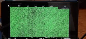

Not sure if it is a coincidence but after updating my Komodo to the latest firmware I am having an intermittent problem with my monitor as per the images attached. It is a FeelWorld LUT6 monitor.
After I reboot the Komodo the problem usually goes away and the image returns to normal. Any thoughts?

I'd say that's screwed. Not scientifically, but had a similar issue and have been in touch with Feelworld and they asked me photograph the motherboard and they then confirmed they can't repair it as they have put new boards in the later monitor and don't have any spares for what looks like your model. Mine had light use comparatively but wasn't in warranty so they offered me a tiny discount on a new one. Clearly I knew I was getting a cheap monitor so can't complain but would think twice buying from them again.
