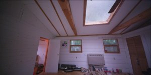

Tom, the 14mm Master Prime (just) covers the Epic sensor. I am hearing that 12mm MP and Tokina 11-16mm also cover the Epic sensor. The Arri Zeis 8R may not cover the entire sensor, but if you crop to 2.39 : 1 aspect ratio, it will cover it fine.

I just want to say that I own an Epic-M and a Arri Ultra prime 8R, and that I have not noticed any lack of sensor covering. how does it manifest ? how would I know ?

You would find it by vignetting (darkening) of the corners when shooting full frame, particularly at fully open aperture.

I tried at low light condition, with the Arri 8R, 6am, full aperture, with the white wall on the left, and there is so much vigneting, the whole left side and moreover the upper left are grainy and terrible... I feel so depressed...
I don't know how I did not see. I just got my 8R, tried only once with big light.
...and put so much cash in it. no one told me at the store.
Is there any way to make it work ?
If i need to crop, is there point to have a 8R...?...
I tried with my Arri master prime 18mm, 1.3 at night, and it looks grainy as well...
thanks you for your help
Ferenz

Tom, that's definitely not something B&H would carry.....and an EXPENSIVE lens....i don't know now what the 8r runs....but 3 or 4 years ago we bought one and it was about as expensive as a toyota tundra.
B & H do NOT carry the Arri ultra primes and Master primes. They DID sell Arri compact primes, but not anymore. They do not take back any expensive item, more than a few Ks.
I was wondering, what is your experience with the 8R ? Red One or Epic...?
IS it working at 5.6... 11...?
which master prime works at 1.3 full aperture...?
Thank you !

8r is about $30000 usd and is t2.8 like the tokina 11-16 which covers same angle of view on 5k as an 8.8mm on 4k. Canon version of tokina 11-16 is $649 and duclos Pl mod is about $4000 and sergey sells the Pl converted nikon (reversed iris and focus which isn't a big deal in a housing) for $2800.
8mm is great for a lot of stuff but can be a bit too wide for some shots like people or sharks swimming side to side or out of shot since the perspective makes them look pretty stretched. So it's nice to have some zoom range.
Sigma also sells an 8-16mm which is good too on redone but haven't been able to check it on epic 5k. It's also f4 so not as fast but with epic "native" 800 iso it would actually end up slightly faster than 2.8 on redone.
