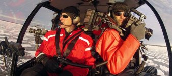

I never went handheld with the RED ONE from a helicopter, but I have to agree that flying the Epic really is a breeze. This picture is from last winter in the North of Norway for a TV series Called "Mission: North Norway" (Oppdrag Nord Norge)
As you can see I made a very cheap stabilizer rig from rubber straps bought at a petrol station. Same ones you use to attach skis to the top of your car.
It worked really well. This together with Warp Stabilizer in CS5.5 made it possible for us to afford 2 months of helicopter use. We were contemlating a gyro rig, but due to the length of our shoot it turned out way to expensive.
I filmed everything from skiing in the mountains, BASE jumping to kiting at the ocean with this rig. For the money, you cant beat it ;-)
It is cold up there though, but I never had any problems with the LCD. What did happen was that the front of our RED ZOOM blew off as some of the screws loosened after a few weeks of flying. I think it was from the vibrations when flying fast and not filming, but still having the Epic outside of the helicopter

This is from a week ago, shooting in -19'C.
The EVF would ghost in the cold, making it very hard to tell what was in focus. Next week when we do this again, I'll use the 5" LCD and will post results.
My friend & coworker (behind me in the pic) using the Stedicam and FS700 got some great shots as well, and due to the focus peaking, was a lot more consistant in his shots.
Any tips would be greatly appreciated.
I´ve only used the LCD when flying. Never had a problem with that. Guess air temprature has been between -5C to -15C. I wish I had brought clear glass for my goggles, as that would have made it a bit easier to judge the LCD image.
I´m going back up on Wednsday to film some skiing, but hopefully it wont be colder than around -10C. I recommend my "hangup" if you have a way of attaching the straps. It gives you more flexibility in hte air. And you won´t get tierd from holding the camera
