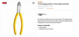

- Best option and the easiest and safest in my opinion is to simply cut off the pin slightly. I'm attaching an image of the simple tool I'm using - I have already cut the one in the photo by the way. It might take a little power to cut the metal pin and it probably won't cut in the first go. But every time you try you cut the metal a bit more so eventually it will cut. You can try swinging a bit left a right as well to make the cut deeper. You can cut it off as much as the Leitax mount allows you to. It will be more than enough to fit in the speedbooster. You might want to cover the back of the lenses with a cleaning cloth or something just in case.

Georgios, many thanks for your feedback! Yes, all my lenses are already Leitaxed. Those look like 'diagonal pliers' to me (like the image attached, can you confirm?)... I'll go and pick some up this evening and see if I can do the modifications over the weekend! Thanks for your insights
