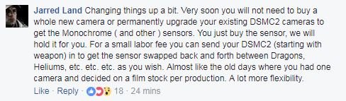

The just announced ability to swap sensors back and forth is pretty huge and makes it less of a gamble choosing a particular model. It may be better to get the Epic-W for this purpose since the electronics are a little beefier and may be necessary for some of the other sensor options. See the picture below for Jarred's announcement about swappable sensors. It isn't clear how that would work with Scarlet-W.
BTW AFAIK the Scarlet-W is not on the netflix approved list but that may just be an oversight.
