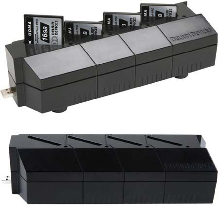

While poking around Adorama, I came across this baby:
Anyone doing multiple cards at once, there is an offering from Delkin which lets you insert 4 (or by daisychaining: 8 or more) CF cards at once. USB2.0 and about 90 bucks.
http://www.adorama.com/ICDIMR.html?searchinfo=expresscard+cf+reader
