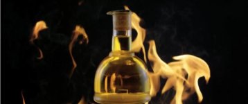

I also agree with Mark as it worked out beautifully for us on Black BG for a Tequila shot with fire... :)
Don't mind the highly compressed screen grab off Vimeo's feed...
