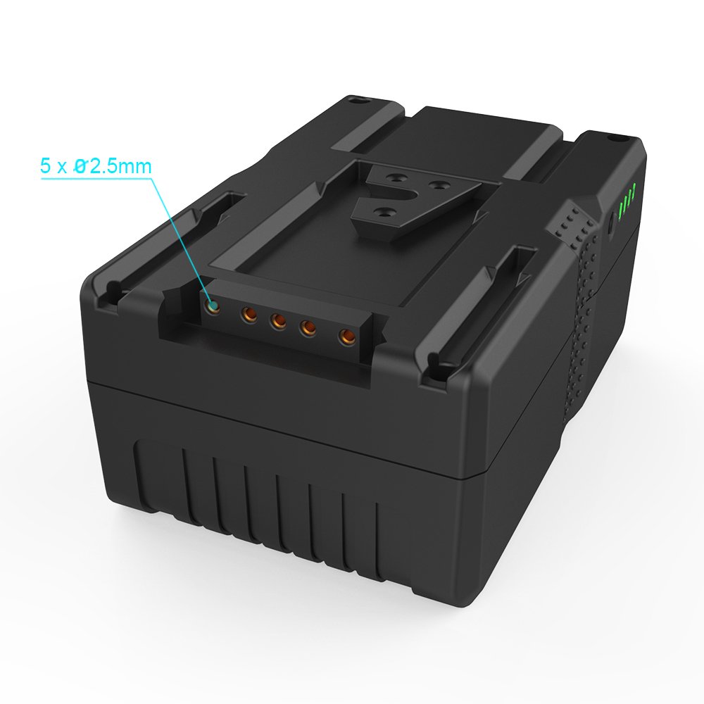

Damn I use the COMER batteries. Same design. Same price for less wH. I am going to order some of these if it turns out they fit on the V-Lock expander. Still don't know if it will fit with the HDMI being where it is.
I've been eyeing these up all day. At 98mm wide, they should fit the expander, albeit barely. Note Brent's quoted posted below about the 100.6mm max with the 9.7mm radius. Based on the pic I attached below, it should clear.
One review even mentions that these units have the chip that shows the remaining percentage on the guys Epic.
The maximum width can be 100.6mm as long as the bottom edges have AT LEAST a 9.70mm radius. Any larger width or smaller radius will not engage properly as it will bump against the I/O portion of the module.
