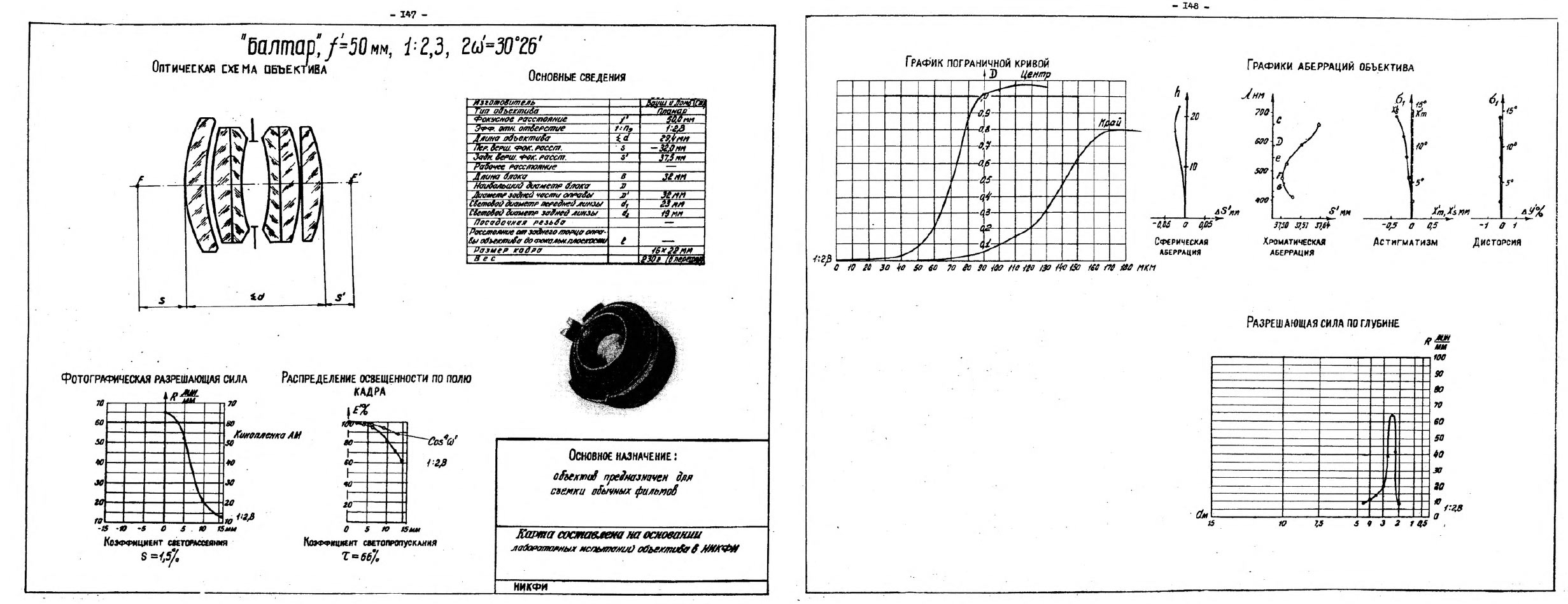

Enough of the marketing adverts, let's put some heavy soviet testing of Baltars!
Here is NIKFI Catalogue of Baltars and Supers:
Baltar & Super Baltar BOOK by NIKFI - a part of NIKFI Catalog of 1969 (with text layer).pdf
Page sampe:
Lenses tested:

It is in Russian, so use this pic as a key:
5ukzc7

What I see from the grafs Baltars 50-75-100mm have a character of its own:
  1. radical sharpness falloff at the edge
  2. red chromatic aberrations
  3. low contrast but good edge definition (sharpness) in the center of a frame
  4. 60-65% vignetting
  5. middle-to high light scattering
  6. very low astigmatism
  7. low spherical aberration
  8. near zero distortion
  9. not so effective coating which leads to low transmission coefficient (60-66% that means 50mm is T2.8, 75mm T2.9 and 100mm is T3.1)

As for the old first series Baltars 50-75-100mm, one can take a look at the optical plots and lens diagrams of 50, 75 and 100mm in NIKFI Catalogue in .pdf at pages 10-15.
