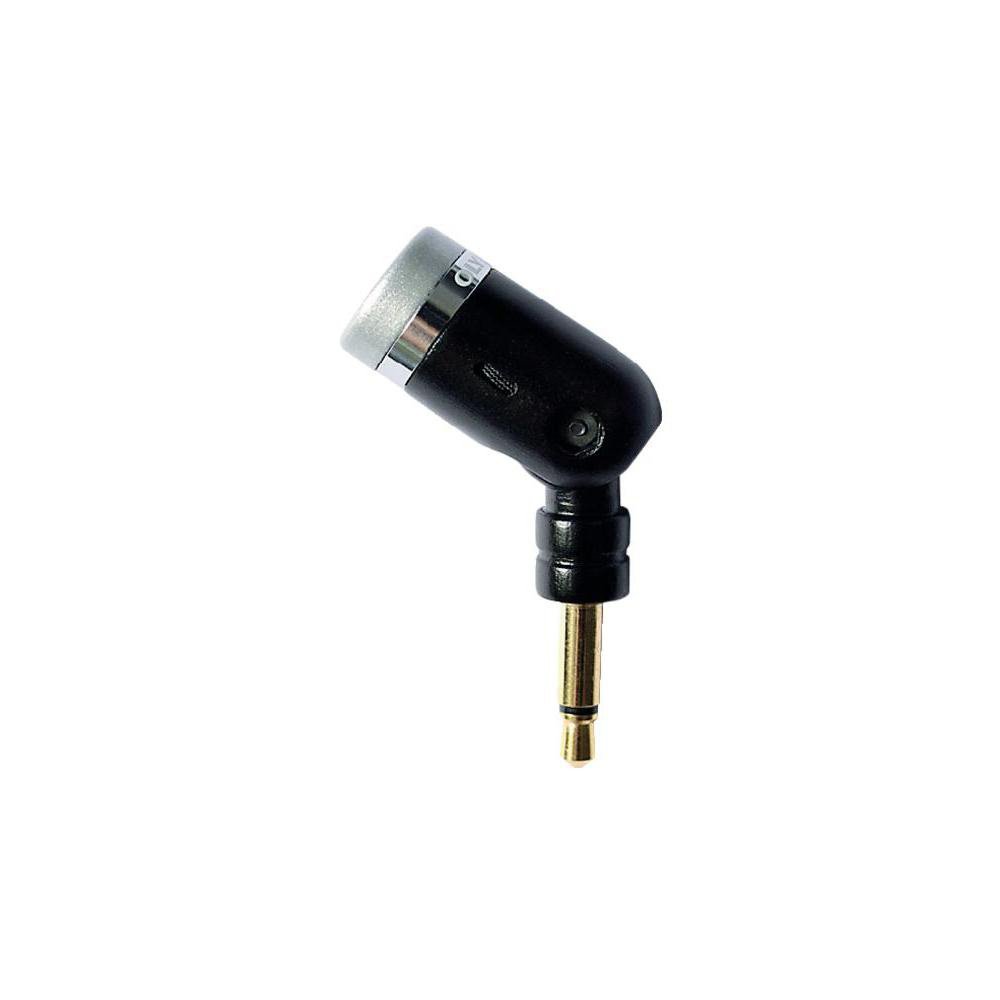

I also use one of these just about all the time. Only $13.
http://smile.amazon.com/Olympus-ME-52W-Noise-Canceling-Microphone/dp/B000MYPPPE/ref=pd_bxgy_MI_img_z
