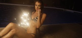

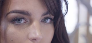

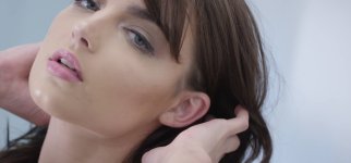

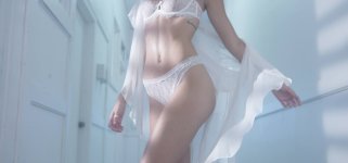

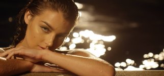

A few days ago, I did my first "real" test on my Raven with a victoria secret-esque beauty shoot as a personal project. Though I'm a director, I also wanted to showcase my DP abilities for hire as well as the slowmo capabilities of the camera. I shot the whole project at 4.5k at 60fps with some at 95 and 120fps, ISOs ranged from 640-1600 (and some at 2000). I really am impressed with the skin tones. Overall I'll say I'm pleased with the images I got, but I will mention that I'm a little disappointed in the amount of noise in darker areas for a camera at this price point. Granted, my ISOs ran high, and you don't always have a budget for adding more light to consistently shoot at ISO 250. Yes, you still have to "know how to shoot" and "have your lighting right" regardless of camera, but coming from the DSLR world, part of me feels like for a camera in this tax bracket, I shouldn't have noise levels relative to much cheaper DSLRs. I will mention that the noise is harder to notice when the video is playing, only when paused, it's hard to tell from these internet stills. But I digress, this isn't a negative post. Just voicing my thoughts. This is still my best looking project yet and besides that, I'm very pleased with my investment and feel like I've taken my work to the next level. These are ungraded snaps. I have added noise reduction into the final color grade of the video. Full video at the link below.

I don't see that much noise on the video, even pausing. It looks pretty organic to me. I like the quality of footage. I personally don't like the large change in skin tone between the different scenes.
If you shot at 2000 ISO and you had higher redcode compression to go to 120fps, I'd say it looks pretty good. I shot with a bunch of DSRL and mirrorless. I don't remember anything shooting 95-120fps so clean at 1600-2000 ISO. If you look how much DSRLs cost now, I think the Raven has a great ratio of cost/quality.

I forgot to add in my original post (will edit) that I added noise reduction in the final grade. My thoughts were more talking about the RAW footage.

I assume you are talking about the bright yellow skin? I see it in the other scenes too where the bright blues go cyan. This kind of oversaturated highlight color is usually from a 1D gamma curve (maybe a strong curves adjustment in post?) as I understand it. Reminds me of Panasonic/Sony Cine/Hyper Gamma curves, which is not a compliment. Not particularly exciting color or DR in this piece but the subject matter is somewhat compelling... :P
On a high key piece like this it's hard to imagine noise could be much of a concern since there are so few shadows. Looks to me more like overexposure with all the blown out highlights and clipped colors.

Perhaps the shadow noise issue was due to not Blackshading for that specific ISO+fps? AFAIK you still have to have the camera hot, hot, hot when Blackshading. I don't suppose you want to put up full sized r3d frames for us to look at? Just for curiosity. :-)

Contrast was intentionally increased in the grade and the pool scene was meant to be saturated. The idea was to try out different looks as opposed to have consistency across the scenes. There was definitely some lighting issues in the pool splashing scenes that I tried to save as we lost sunlight. What other scenes (put the time marker) do you feel the color/skin tone was off? I'd love to hear your suggestions on how you think I could make this look better the next time around. Sincerely, I want to get better next time around.

As far as skin tones, they look fine to me. I personally don't really like blowing out highlights when I can help it. Might've been a stylistic choice
