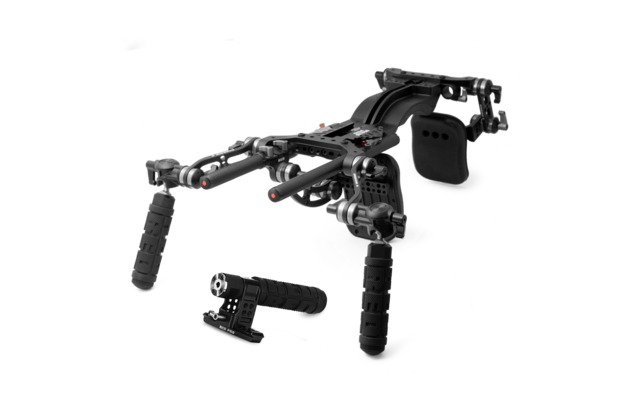

3- months and a couple projects in from purchase I've had a chance to get pretty familiar with the Titan system and still feel like I made the right choice for a number of reasons:
Of the 4 options, Titan was the 2nd most comfortable that I tested on the show floor. And as promised by the developers, the final product is an improvement over the prototype they had at NAB. The shoulder module allows for a little bit (the website says it's +/- 20 degrees) of rotation to actually match the slope of your shoulder. Having dislocated my shoulder some years ago, I'm really sensitive to poor ergonomics and the Titan system works splendidly. It doesn't lock with a rosette like the Razor however I actually found that to be a benefit when operating since it let me shift the weight around a little bit every so often to keep things comfortable. There is a friction lever which adjusts how difficult it is to roll however in my testing I found that with so much leverage and force from a 10lb+ camera and long arms there is almost no difference between the "tight" and "loose" settings; if you want to roll the camera it'll roll regardless. What the friction lever on the shoulder pad does seem to accomplish is the ability to make tiny adjustments forward and backwards to dial in the balance. I've shot for more than 6 hours straight with the Titan, only taking the camera off my shoulder for a couple minutes at a time to rest and found this ability to shift the weight, even if it's pretty small, very helpful in keeping my shoulder fresh. I'm not sure if even my first pick for ergonomics on the show floor, The Razor, would have been able to keep me fresh that long. All in all the Titan reminds me a lot of my similar-in-name-sounding-Herman-Miller-Aeron chair; when you first sit in it... it's not the most comfortable thing you've probably tried but after a long day when your back isn't killing you--you recognize the ingenuity of the ergonomics.
The arms and grips on the Titan are mounted onto a mini-dovetail of sorts that slides into the front of the bridge plate as a single piece. In order to switch between a tripod and a handheld configuration you:
1) lift up on a tiny pin and slide out the arm and grip assembly
2) flip one lever to release the shoulder pad module and...
3) mount your camera on the dovetail as with any other bridge plate setup.
The whole process only takes about a couple seconds and was one of the things that really appealed to me about the design. Of all the systems I tested Aeon was hands down the fastest in its ability to both transition from handheld to studio but also for configuration. The trickiest part in the process is step 1 as it can be difficult with rods and lens etc to reach the pin release. Aeon says they're looking into a fix however it's not by any means a deal breaker.
The arms themselves are similar to RED's Clutch. The base package ships with two wishbones per side (as opposed to The Clutch's single wishbone per side) and then a two-axis wrist for the grip. The website and videos show a single friction locking ball joint however the shipping model is a double-rosette angle bracket. I think I would prefer the ball joint since adjusting two rosettes is pretty tricky to get right however I really like the double wishbones for the arms. They can be a little tricky to get the hang of but I can very quickly rotate up the arms so that they are short and close for documentary style shooting or drop them down and out for a more relaxed configuration. I felt like The Clutch's range was a little too short with a single wishbone per arm and holding your arms up too high causes shoulder fatigue and strain very quickly.
The arms also have standard sized mounting points along the wishbone. I generally use these for mounting a noga arm for my LCD however Aeon also ships a tiny mounting bracket as well that lets you directly mount your RED LCD to one of the wishbones. Both worked well however screwing your LCD onto the arm directly runs counter to my desire for ultra fast conversion between handheld and tripod. I'm considering picking up a couple NATO rails and switching my LCD over to a NATO system to switch back and forth. Aeon also makes a top mount which looks fantastic but is a little too rich for my blood. So far my $30 Amazon Israeli arms are working well.
The Titan system also ships with the option to place a wishbone in the back and mount a battery plate. This setup lets you significantly lower the center of balance or better balance with a long zoom. I was initially a bit turned off by the setup just because I would either need to buy a second battery plate or else screw and unscrew my battery plate from the Aeon back plate and my x quick release plate. I came up with a clever solution though. I just bought one of the RED accessory mounts (http://www.red.com/store/products/accessory-v-mount) and put that onto the Aeon battery plate. Now I can in seconds slide the battery plate off the back of my epic and onto the battery on the shoulder rig. Alternately I'm exploring options to use the rear wishbone suspended plate to mount my Blackmagic Shuttle for Pro-Res recording. Ideally now, inspired by my success with V-Mount battery plate I am trying to figure out a way to add a x accessory v-mount adapter to my BM Shuttle. Having a nice little balancing arm on the back for accessories has opened a lot of options and I don't feel like I've even scratched the surface yet on how to maximize the potential there.
All in all I've been extremely happy with my Titan rig. With a busted shoulder and a bad back, ergonomics is non-negotiable for me and the Titan met and exceeded all of my expectations. I realize my demands on transformation speed might be viewed as excessive by some :D but to the Titan's credit it actually met my somewhat outlandish dreams. I've had a couple teething issues (one of the rosette joints was loose and needed a little tightening and locktite) but most importantly Aeon Cine has been really responsive feedback and made sure everything works perfectly. I'm more than happy to troubleshoot tiny glitches if it means the manufacturer is engaged and supportive. I would rather have a few tiny bugs that can be fixed quickly than to feel like I'm on my own without any support. I haven't had the Titan long enough to speak to its long term durability however the build quality overall feels generally excellent in my use so far and should I run into any problems based on my experiences with the Aeon Cine team I have no doubt I'll be taken care of in very short order. I don't review very many products but whenever I run into one like the Titan I feel obligated to share my experiences and put in a good word where a good word is due.
Speaking of giving credit where credit is due I did run into one big show stopping problem when I received my Titan and that was that it's incompatible with the WC dovetail. Apparently there is a slight mismatch between an Arri dovetail in practice and what the theoretical design would suggest. The Titan design assumes that the corners are beveled (as are all dovetails in practice except for WC's) which results in WC's dovetail being slightly too wide at the top. To Wooden's credit when I brought up this incompatibility they offered to refund me my dovetail even though I've had it for over a year and even though they arguably aren't in the wrong. That's some amazing service right there as well and is just one of many reasons why I also love Wooden's products and people so much even if I didn't end up going with their shoulder system.

So I had a little breakthrough in that I didn't need the battery plate in-between the red v-mount point and the Aeon battery arm. Here is a quick video on how quickly you can switch between a lower center-of-gravity and a tighter rig depending on the lens size. This video just demonstrates how quick you can change between the two layouts.
Here is the little rig I have setup for my Blackmagic Shuttle for ProRes and DNxHD proxy recording:
This lets me have both a battery on the back of the Epic and then have the Blackmagic Shuttle on at the same time. .
