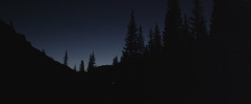

After using the MX outside at night (also in the forest) I'm happily surprised that Dragon is useable up to 4000. I attached a frame from an MX shot last year, shot at f1.8, 1/48, ISO 1600. The scene was MUCH brighter to my eyes in person, but I think the shot worked for my purposes despite the fact that there is NO information in the shadows. That little spec of light in the middle is actually my (very bright) headlamp. If Dragon is really that much of an improvement, I'm psyched to revisit this in a few weeks. I wouldn't have pushed the MX past 1600.
