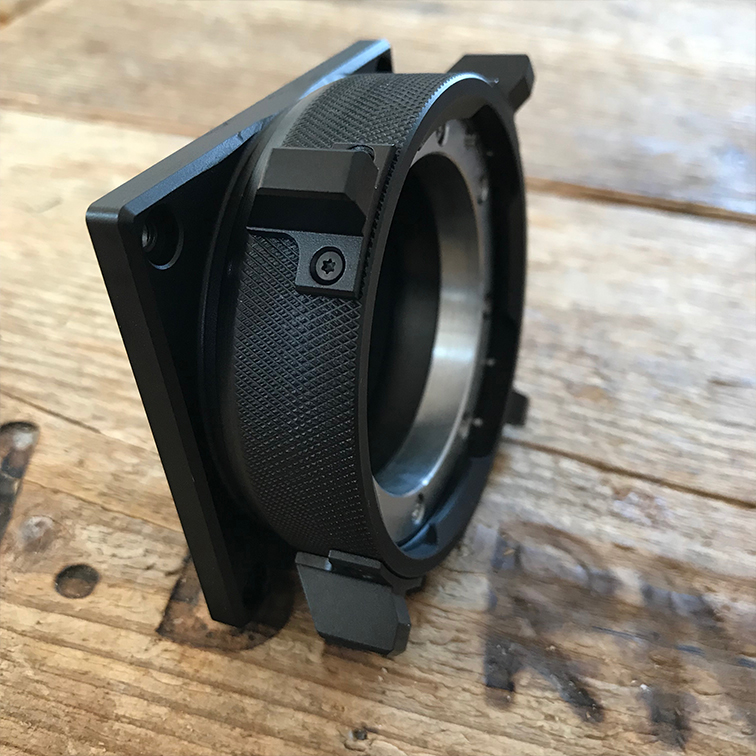

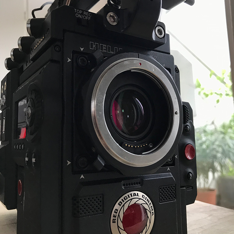

After waiting for weeks to receive the prototype parts, we finally yesterday fully assembled the SpeedMount EF mk2. We will make some minor adjustments to the design and start the first production run next week. So everyone who preordered a SpeedMount mk2 PL or EF should receive them in June.
We will offer for all SpeedMount EF mk1 customers an upgrade to mk2 for free when they are finished.
Attached is a photo of the first fully working SpeedMount EF mk2 prototype on our Helium and a photo of the SpeedMount PL mk2.
