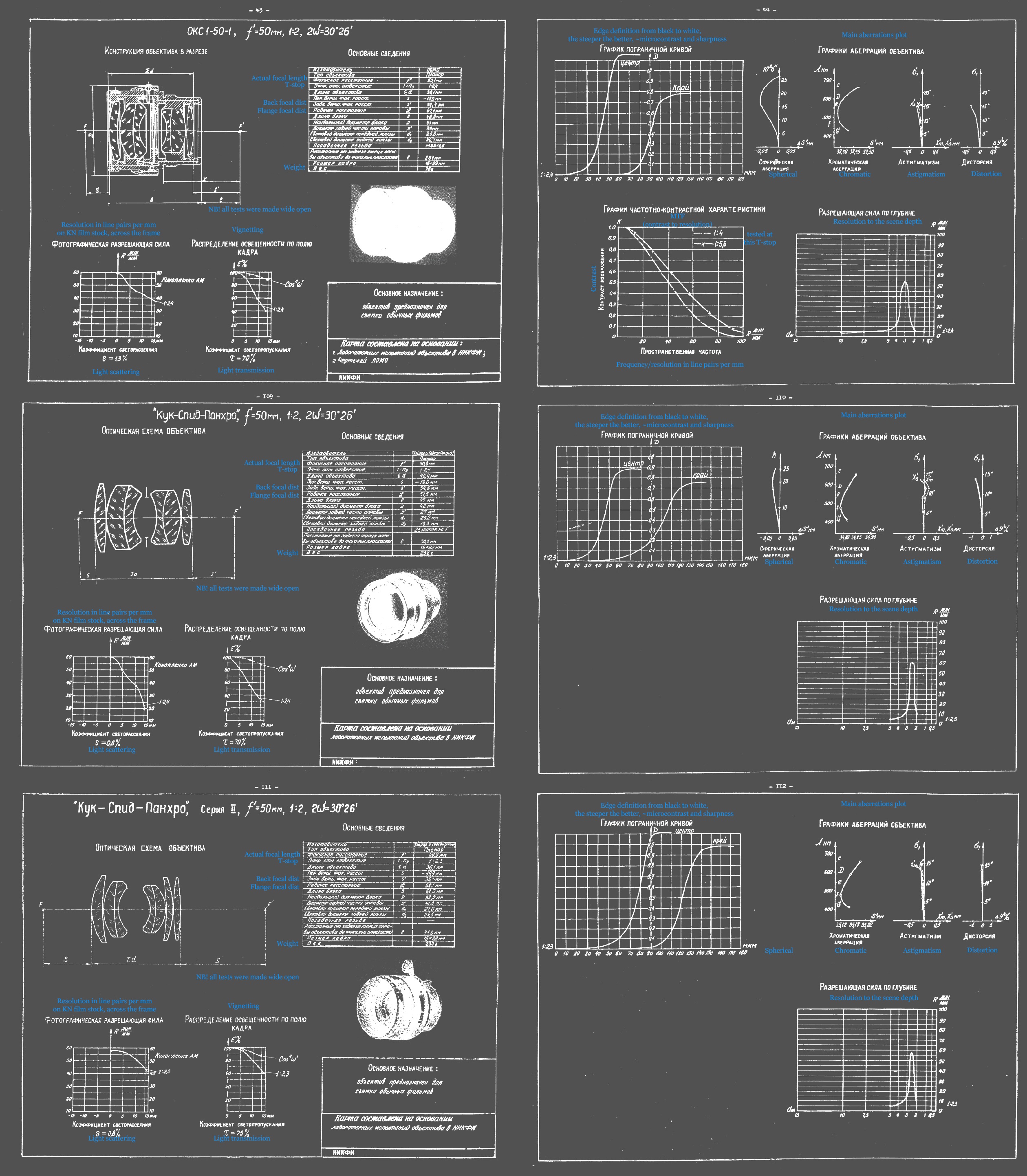

A little vintage cine 50mm lens comparison, OKS vs Cooke. Oks1-50-1 vs Cooke Speed Panchro vs Cooke SP Ser.II
Here is the lens schemes/diagrams and main optical characteristic taken from the NIKFI Catalogue of 1968 for pure lens nerds:

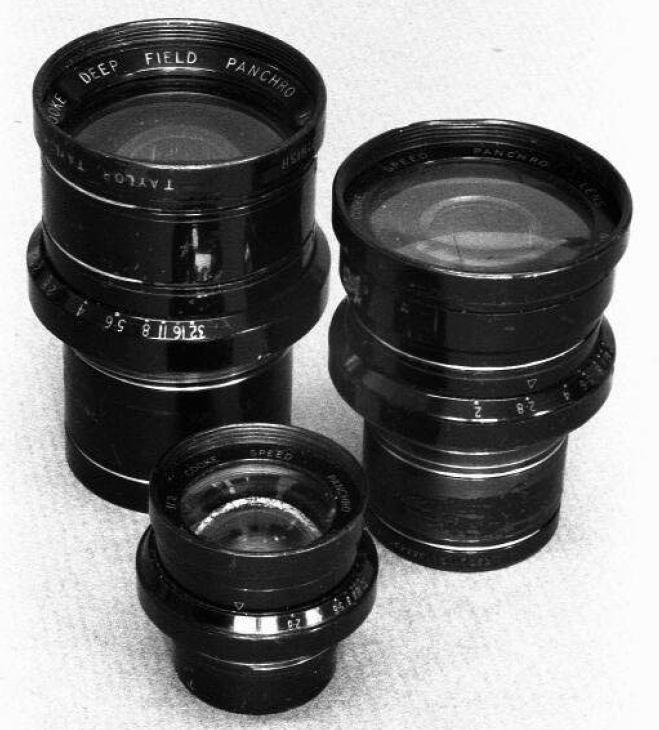

Cooke Speed Panchros first version look like this:
Xx3yQb
They were in production like late 20-s to postwar times. These at the photo are in black enamel finish (brass barrels) with round L-shaped wires locking the lens cells from loosening.
All or most were uncoated.
well, technically speaking Cooke 50mm ser.II is a killer lens even as of today standards, better than oks1-50-1!!!
50mil ser.II has nearly zero distortion, nearly zero astigmatism, very good chromatic aberration correction, low sharpness falloff, high contrast black-to-white transition (edge definition).
!!! that been said guys you gotta keep in mind that in real life situation one must test both lenses to choose the better one cause there is ALWAYS lens copy quality variation!!!
Besides this NIKFI Cat-s choose the best oks1-50-1 I think:-) whilst I am not sure if it was the case with Cookes. I think they tested what they had at hand, still I am sure they would NOT take obvious bad copy of Cooke.

Adding Lomo OKS 75mm oks1-75-1, oks6-75-1 versus Cooke 75mm SP and SP Ser.II grafs:
m9c7Qr
Tommaso Alvisi asked:
Ah btw what do you think of Cooke SP 50mm Ser II VS 1-50-6 ?
— I have searched for 1-50-6 test diagrams, but found nothing. Since the first two digits are he same as in oks1-50-1 I think they are more or less optically the same but oks1-50-6 is later model, mod number 6, could have reduced front or back element (?), has a bit different optical block barrel and has multi-coating. Why I put comparison here? If 1-50-1 and 1-50-6 are more or less the same, it's classical opic/double gauss/planar 6/4, — so, we can take 1-50-1 graphs from above and compare it to Cooke SP II. But again, till I found the real graphs of 1-50-6 my comparison in that thread is pure theoretical.
On the other hand, one need to gather two lens together, oks1-50-6 and cooke sp II to make a real test. I have 1-50-6, but no Cooke SP II...
And 75mm Ser II VS 6-75-1?
Also 1-50-1 VS 1-50-6 and 1-75-1 VS 6-75-1 ? Personal opinion on bokeh? Less/more swirly? Harsher/Smoother?
These Lomo designs should be more modern and theoretically improved but what's your take? ;)
The fact that newer Lomo designs have (I think?) a more complex double gauss design so bokeh could suffer?
— No, both LOMOs are double-gauss planars, the 6-75-1 has just all 6 lenses not cemented for better correction (uses air gaps as a lens). It has original 6/6 formula but still double-gauss, so I do not expect bokeh to suffer. Overall technically 6-75-1 is superior to 1-75-1: more resolution, less resolution fall-off, multi-coating, sharper definition (black-to-white transition), a bit better CA correction, bit less astigmatism, has a technological advantage of a shorter back focal lenght — all these advantages are just marginally better, regular user won't ever notice the difference between 1-75-1 and 1-75-6 (despite the MultiCoating and color, the latter should be less warm but still it has a reduced transmission in violet-cyan range so again warm look, see the Spectral transmission graph). So all you notice if put both head to head on camera is, realistically speaking, more of a lens copy variation but not the true lens difference.
In what oks1-75-1 advances oks6-75-1 is the distortion — it is just negligble, ~-0.2% at image edge while oks6-75-1 has -0.7%. Do not think these are high values, for example Zeiss in their MTF brochures calls that numbers "the absence of distortion".
