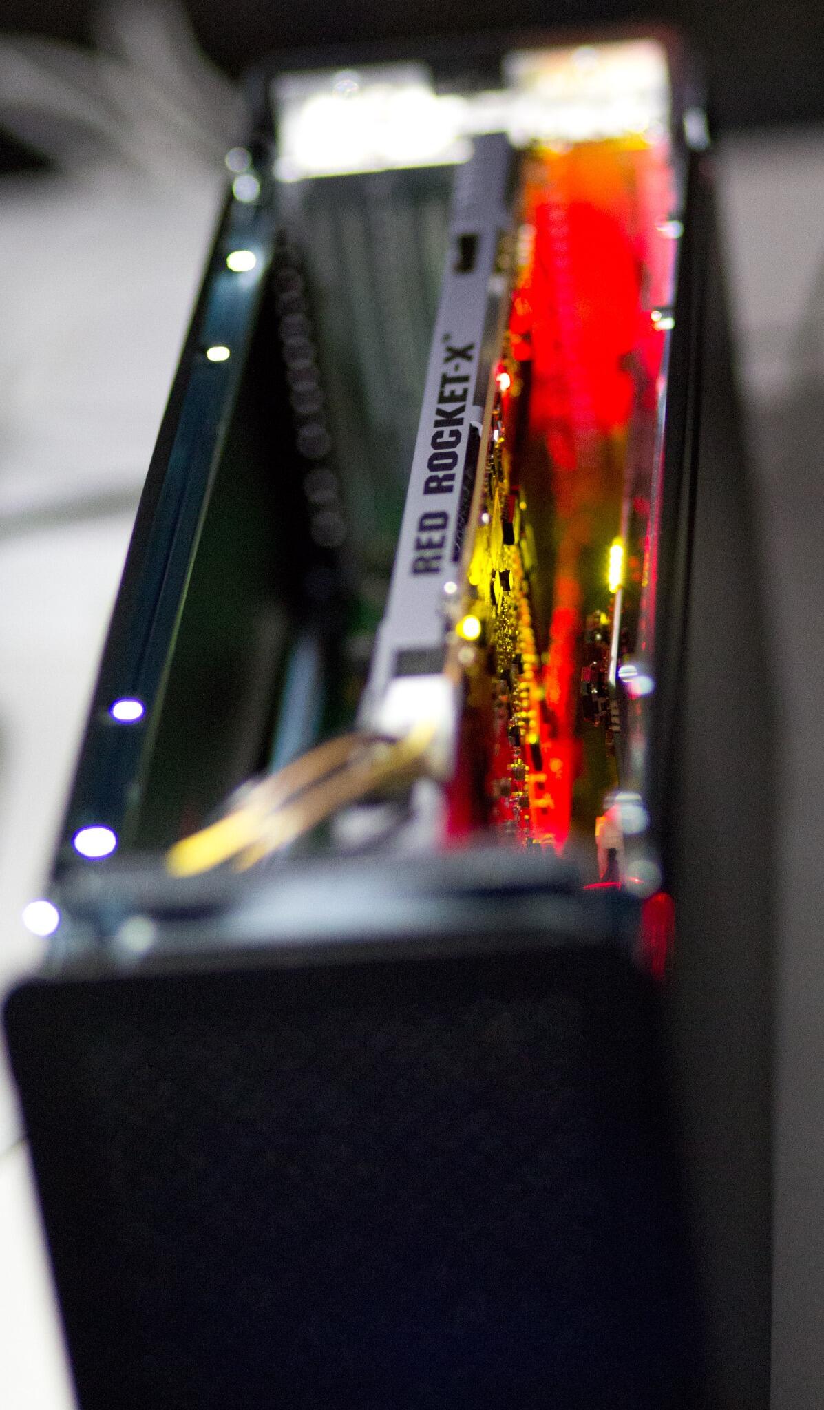

The MAXX Digital one should be out next month.
BeMwjF2CUAAkEB8.jpg:large
I called Maxx Digital, they dont have any to test or anything.
So if anybody has something that can be tested even if its TB1 id like to know.
I would love to test asap
thanks
Hi Lu,
I have the MAXX Digital one, RRX installed here in the OC. Tb1Picked it up at Ron's 2 days ago.
I was there and talking with Devon as well about doing some testing with the CFDragon-perhaps this week. Lemme know, if you are available and interested.

The RED Rocket-X requires a true 16x PCI-E lane. Not going to work with 4x/8x TB1 enclosures.
We have been exploring this as well. We have learned that our existing CUBIX Rackmount 6 that is about 3 years old now and running our Rocket, can't support Rocket X because it only has 8 lane electrical throughput even though it has 6 PCIe x16 slots!
Have to do an upgrade, which will be PCIe version 3, 16 lane for both newer GPUs (we have Quadro 4000's currently) like the 780's, Titans or the AMD 9100's.
The data throughput on these cards is way higher than TB 2. I don't know what the throughput is on the RRX, but I would be concerned about it being bandwidth limited in ANY TB enclosure.
Black Magic is advising that the RRX go inside our 5.1 MacPro. But we're still investigating whether that's necessary.
