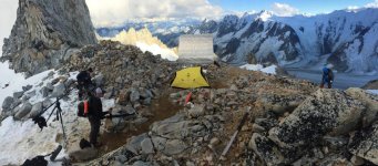

I had a shoot just last year on a remote mountain range in British Columbia with similar temperatures. Anticipating the same battery issue I brought 8 bricks as we were going to be there for 6 days with no access to heat other than our bodies. We did fly in a 2000 watt Honda gen to charge at night when it was its coldest. We comfortably pulled off 8-10 hour shoot days on 4 -5 bricks. Granted we had blue bird skies so the sun bouncing off the glacier was enough to make me strip layers at times. I ran test with hand warmers by taping them to batteries setting them in a Yeti soft cooler and sticking them in the freezer and they had no effect. I brought a ton of them anyway and just ended up bringing them back. I found unless they are constantly agitated they don't produce heat.
As for our dragon it did great with no issues. 7" monitor no issues. Basically everything I anticipated going wrong I doubled up on but it was better safe than sorry. Best of luck on your shoot!
