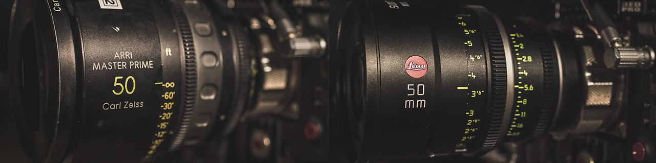

1. Zeiss Master Primes

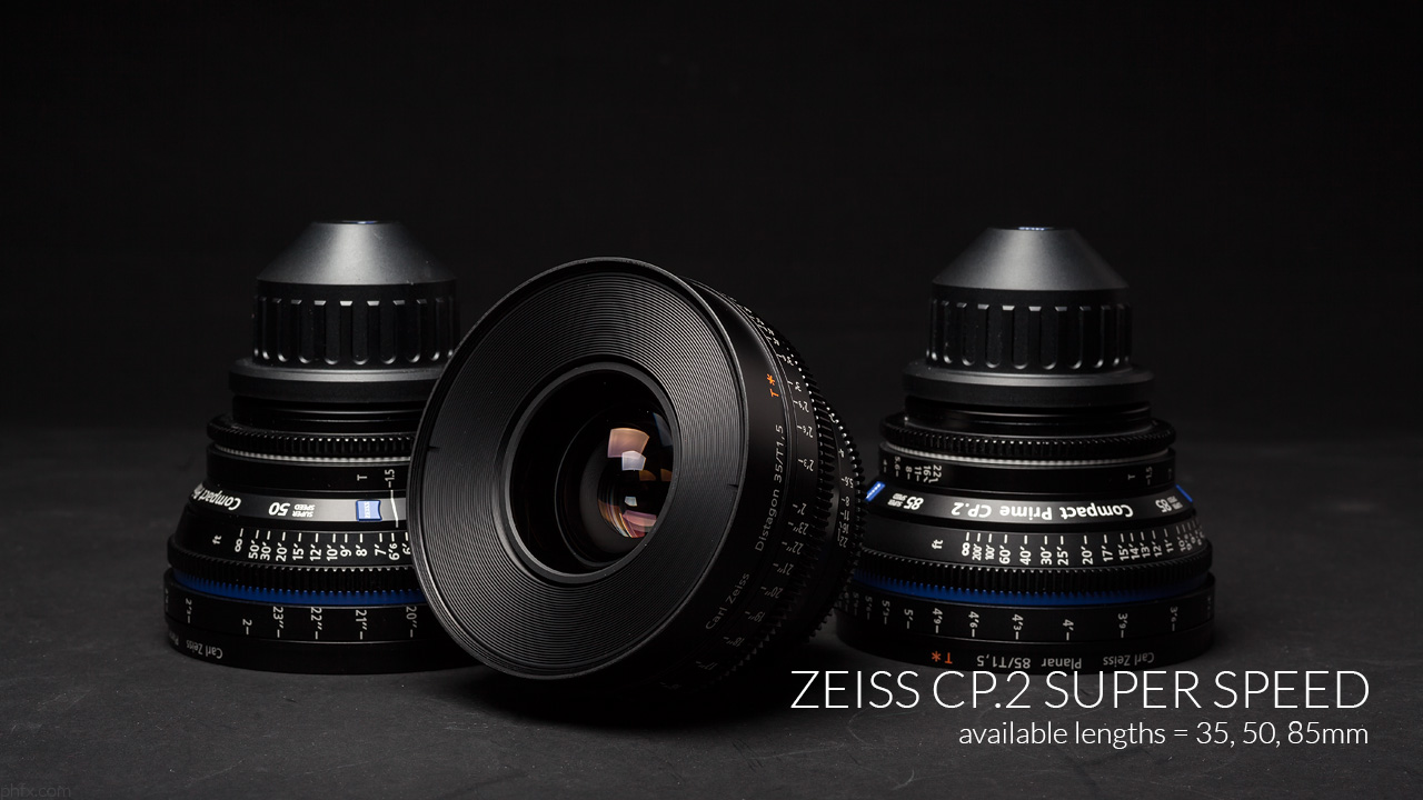

2. Zeiss CP.2 Super Speed

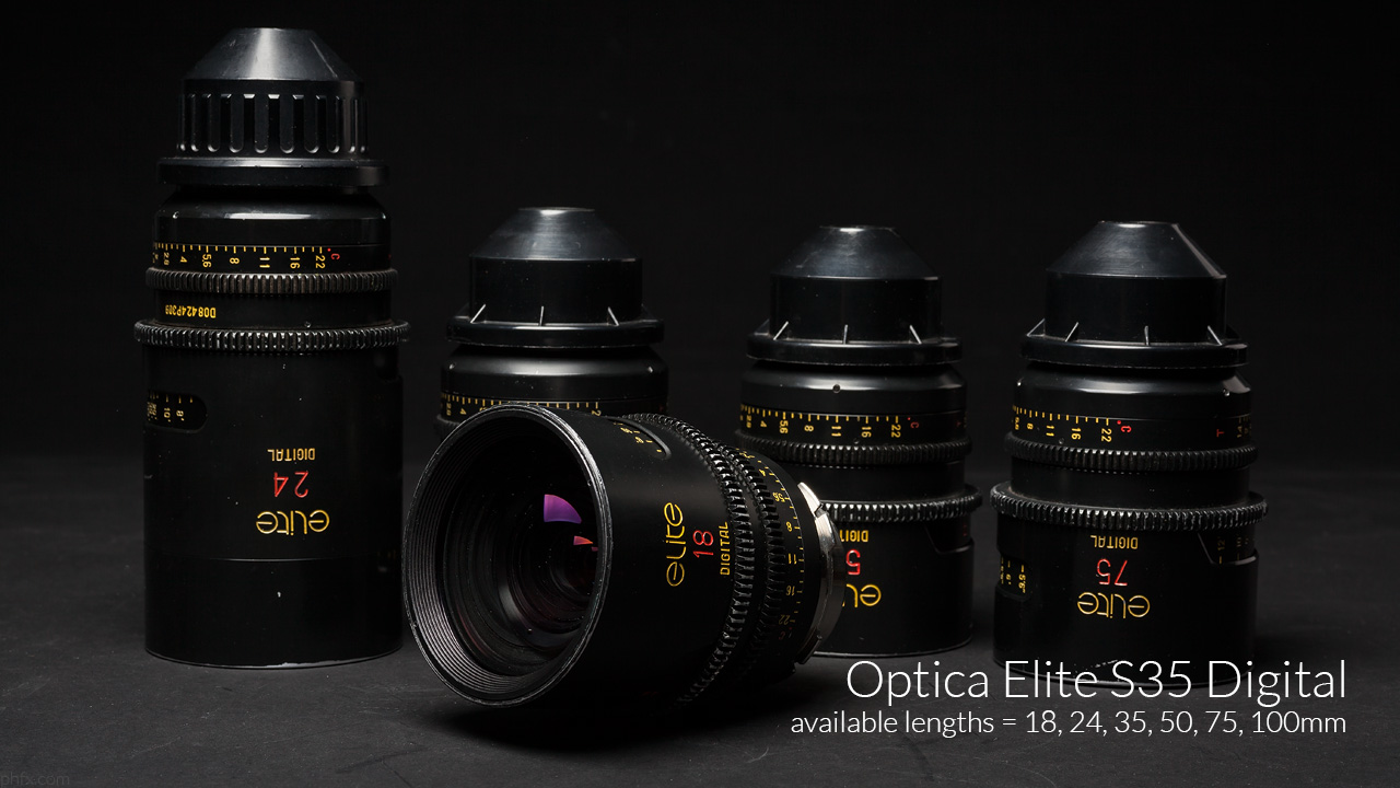

5. Optica Elite S35

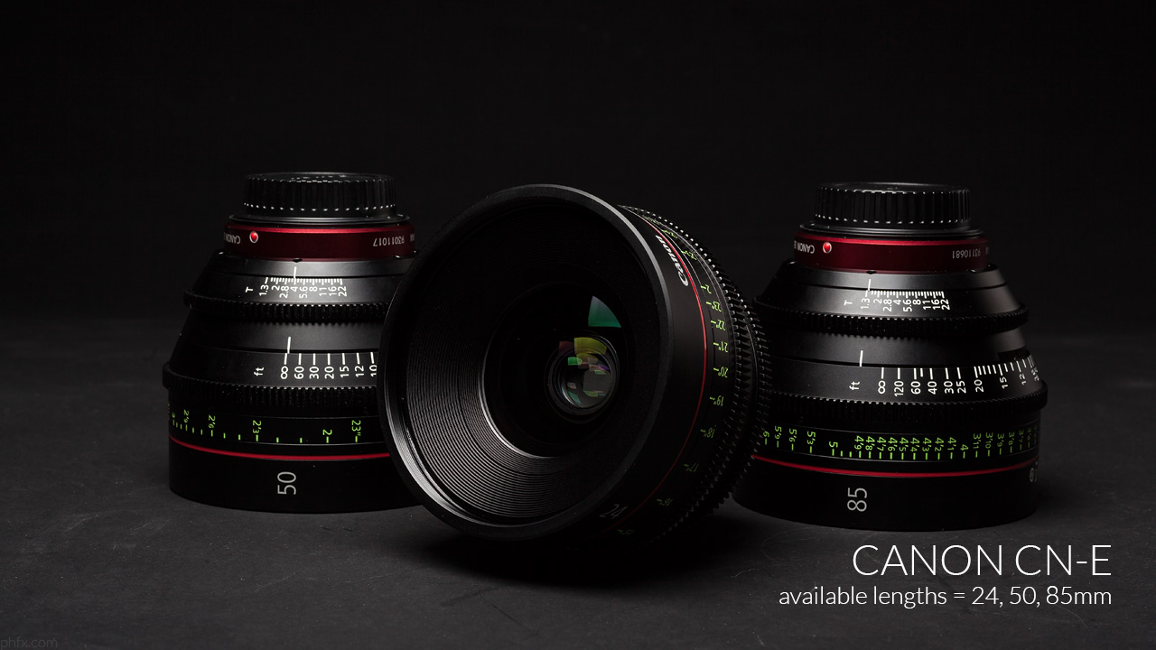

8. Canon CN-E

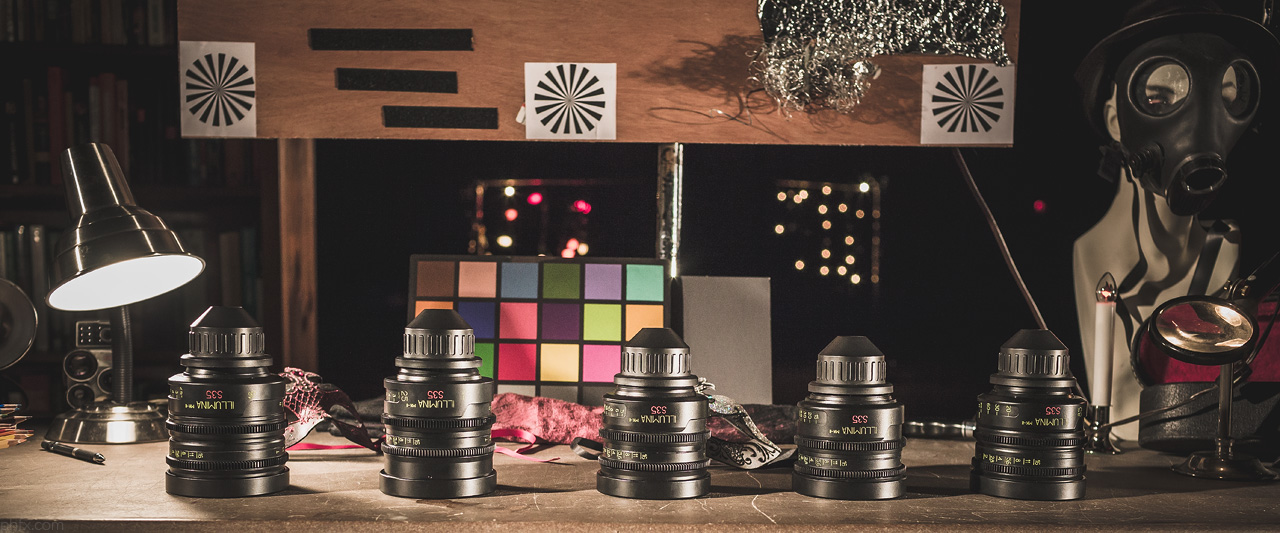

Torture Test:
This shot was designed to push all the lenses to the edge. If you plan on using these lenses wide open you need to view them at their worst. This test will show the differences in Resolution, CA, Contrast, Flare Characteristics, Bokeh, Breathing, Distortion, and Color Rendition. The test was performed both wide open and at T 2.8. For each focal length increase, the camera was moved back to maintain a similar frame for every lens. The test was captured with the Red Epic (5KFF, 320ISO, 23.976fps, 3:1 compression, 3200K) due to the high resolution sensor and ability to change lens mounts in a minute. Shutter speed was used to control exposure. Focus was confirmed for each lens in a 3 step process. First using the built in focus assist function, then by eye off the siemens chart, and finally confirmed on a 1080p on set monitor. All this was performed after the distance was confirmed with a tape measure.
Here is a look at the test in action:

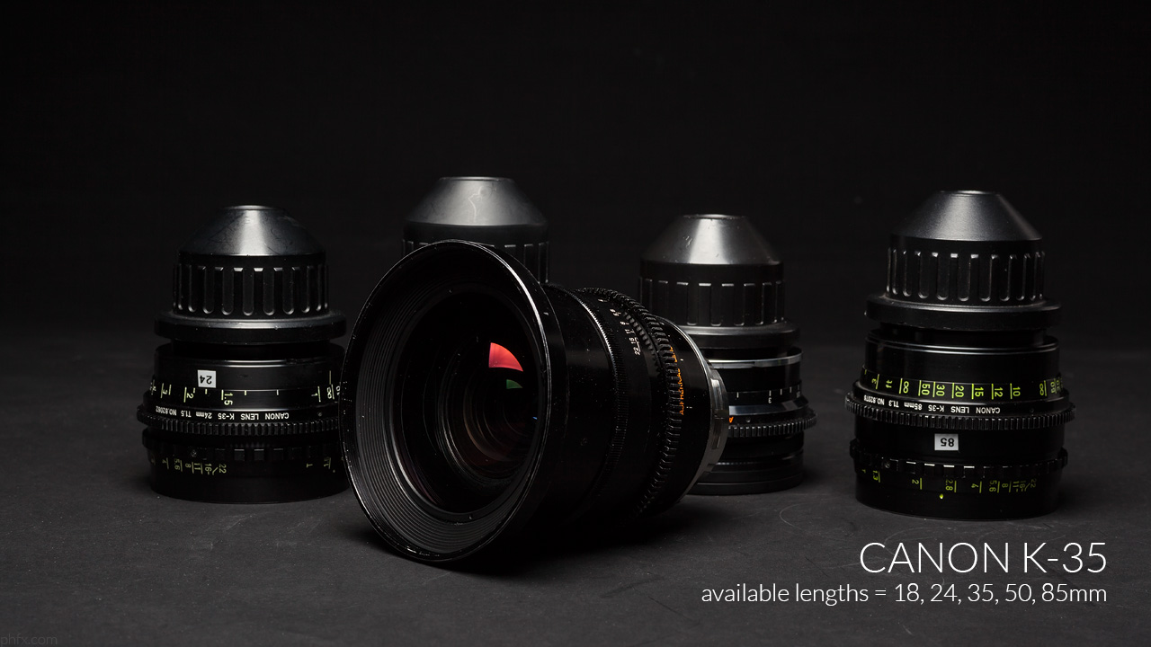

7th... Canon K35s
To say that the K35s disappointed me is an understatement. For the last 2 years I've heard people raving about how much better they are than the Zeiss Supers but this set at least did not bear that out. I found pretty much nothing I could really love about these lenses, they showed far too much CA and the 85 was pure mush wide open. Even the bokeh had a bit of a double image I found unpleasant. Again, i've never been particularly fond of Canon glass but I expected better from the famous K35s.

5th... Optica Elites
I like Russian glass, it has an organic character that really helps to soften the "digital" look of some other high end lenses. Technically there are many things not to like about these lenses but the images somehow still come out pleasing, unlike the Canon K35s which have most of the same issues but none of the visual character of this set.
The only thing to dislike is the barrels, Russian glass is fairly hard to maintain and work on and replacement parts can be hard to find.

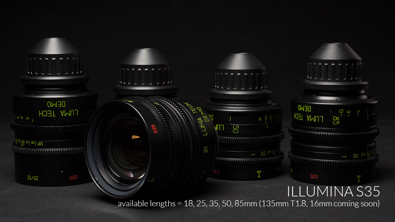

4th... Illuminas S35s
My impression is these perform slightly better technically than the Elites but have a very similar "Russian" look as is to be expected. They also offer better barrels, mechanics and service since they are a currently manufactured product.

1st. Leica Summilux "C" primes
The new kid on the block truly is the king. They needed to truly do something special to beat the Master Primes from their rival german juggernaught Zeiss but boy did they make some scrumptious glass. I've been shooting Leica M for 15 years and they are hands down my favorite lenses and these live up to that heritage and then some. If I owned a super-car to hock in order to get a set it would have happened already, but you knew that of course.

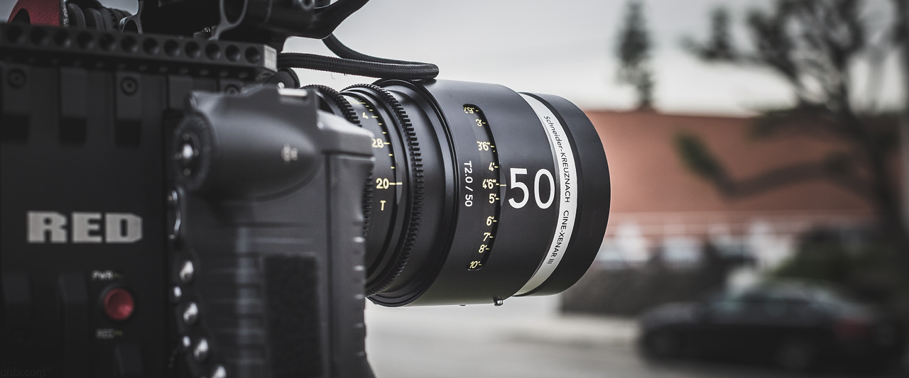

There happened to be a set of Schneider Cine-Xenar IIIs at Duclos on our test day and it just wouldn't have been right to leave without at least throwing them up. My very quick impression is that these are the "Sleeper"set of 2013. They looked the closest to the "Optimo" look of any prime set I've yet tried. The lenses were larger than Ultras but not as big as RPPs or MPs. Breathing was non-existant, sharpness was stellar and the bokeh was luscious. I'm hopefully going to be able to borrow a set for a music video coming up so with any luck you'll have a chance to see them in action.

The Stress Test was conducted at Red Studios Hollywood. Big thanks to Jarred and Carrol for allowing us use of Stage 3 for the day. Will brought the books and Matt Uhry brought his highly effective "Torture Board". Most of the weird props are from me, but they were chosen for a reason. Matt Hayslett and Ryan O'Hara operated the camera for the whole day. Everyone kept open eyes to make sure nothing was being missed out on. Matt and Ryan will have some great info after operating the whole day.
The critical observations I'm primarily looking out for this setup are various types of optical aberrations, illumination falloff, how/where detail resolves on the focal plane, depth of field, focus plane object separation, perspective draw, chroma/tonal consistency, and how nice the out of focus image (bokeh) appears. Additionally, during the focus pull, you'll be able to make notes on breathing and image shift.
What's extremely important to keep in mind is that this was a stress test. Meaning we were trying to make the lens do funky things. That said, most of these lenses cleaned up a lot of their wide open performance aberrations by T2 or T2.8. Especially the newer glass.

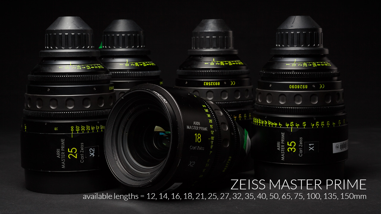

Zeiss Master Primes have earned their reputation in the industry. I'm fairly familiar with these lenses and I'll be using them as the measuring stick when looking at the other lenses from this test. Optically these lenses perform extremely well, virtually no breathing, well controlled aberrations, and impressive wide open performance. From 14mm-135mm you are looking at a consistent front filter size of 114mm. From 16mm-100mm you are looking at a consistent lens length of just over 6 inches. This is desirable on set and helps speed things up and minimize rig adjustment during lens changes. Focus pulls are smooth as can be really. This is a well maintained and serviced set as well. Some things that people don't particularly love about Master Primes is that they are fairly hefty and bulky per lens. This may or may not be of concern to you, but I've heard more than one horror story involving people dropping them due to small slippery hands. They do have a look to them overall. It could be described as cool and clinical. Very contrasty too. Overall, these are top tier lenses and what many hold as the highest standard in cinema primes.

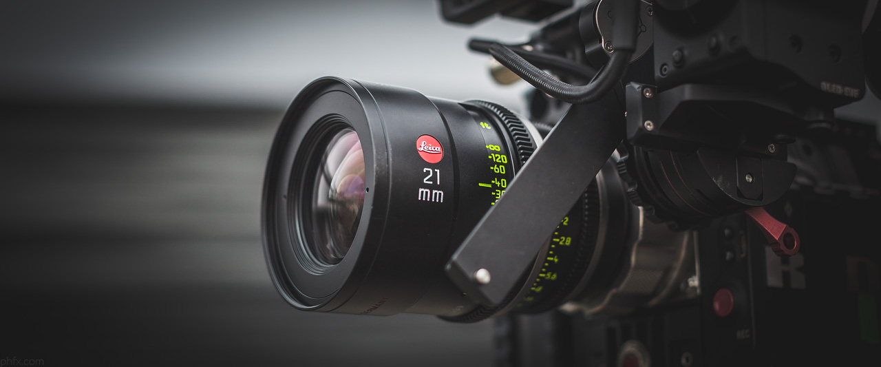

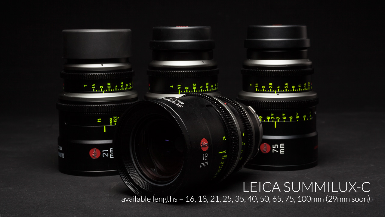

The Leica Summilux-C lenses are the relatively new guys on the block in the high end cinema glass realm. There's a lot of good things to be found within their design. They are around 3.5-4lbs per lens. Throughout the range they have a consistant length of 5.6 inches and a front diameter of 95mm. Built really well and also virtually no breathing. From a Red shooter perspective, I love the size of these things on Epic and Scarlet.
I've had experience with the 40mm and 75mm before this test and really liked what I saw. After looking at our test images I'm beginning to like them even more. Whatever Leica is doing with it's modern elements and coatings is fairly tremendous. There's nearly no chromatic aberrations exhibited across the range (it almost produces what I would describe as a "holy glow"). Better performance on that front than Master Primes in my mind. Spherical, coma, and astigmatic aberrations are all really well controlled as well. Additionally I like the flatness of field and separation that you see on the Summilux-Cs. They have a bit of flavor to them. You will notice a bit of a sparkle on your out of focus hot spots for certain lengths. This is clearly part of the design and you will notice as you close your aperture down you will see a unique pattern form from the iris blades. They are pretty contrasty and I would say have a very slightly warmer feel to them compared to Master Primes. These are cinema lenses that seemed to be designed to have a subtle yet distinct look to them.

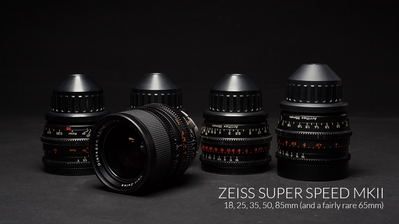

I have to say this is a pretty nice set of Zeiss Super Speed MKII lenses. Especially the 50mm. These are great little workhorses overall. They are all nice and compact and feature an 80mm front diameter across the range. Built to last, which is one of the many reasons you still see them in use. The aged and dated coatings show a bit. Fairly contrasty overall, especially the 50mm in this set. There's certainly chromatic aberrations exhibited across the focal range. Also, they do ghost and "glow" a bit. I would say the Elites exhibit that the most agressive ghosting, the Leicas, K-35s, and MKIIs having a bit less of it at 50mm. It's there though. That all mostly clears up by T2/T2.8. The do exhibit a bit of breathing when racking focus, but it's not too bad. I would say these have a similar Zeiss coolness about them. I've always liked the look of the MKIIs. No real shockers on this front. Hard to beat for such a portable set.

The Elite S35 Digital are a pretty interesting set of lenses. They have a consistent front diameter of 85mm through the set. I'm somewhat baffled by how long the 24mm design is though. I would say it's going to be a showdown between the Elites and the Illuminas as to which set has the most "personality". I mean this both in positive and negative ways. The Elites exhibit a healthy amount of chromatic aberrations and ghosting. Much clears up stopped down to T2.8. The lenses do have a unique quality to them, especially the out of focus image. They aren't as contrasty as the premium cinema lenses. I think the 18mm is pretty nice overall. The 24mm isn't exactly a 24mm and is noticeably wider than the other 24mm lenses tested. The 50mm ghosts and blooms wide open in a an aggressive way. Overall this set left me wanting more. They provide a unique look and familiar bokeh across the set (wide open it's very exciting on not so controlled). But these have some quirkiness about their build and optical performance. Chromatic aberrations still pop up at T2.8 at most lengths. I would say they are more contrasty than the Canon K-35s and pretty close to the Illuminas. The Elites are prone to flare, which is both a good and bad thing depending on your creative intentions.
**edit 14mm T1.8 coming soon. Not 16mm.
The Illumina S35 lenses were another set I was happy to finally get my hands on. I've heard and seen extremely varied and confusing things about these lenses. There are simply not many sets out here in Southern California. First handling them you get the feeling that they have crammed a whole lot of optics into the lens tubes. They have a solid feel to them. Mostly around 3lbs, they all feature consistent 95mm front diameters. Their size is actually very appealing to me for use on Epic and Scarlet cameras. In a similar way to how the Leica Summilux-C lenses feel "ideal". One design issue is that pressing down on the front of the lens induces friction which causes an effect that I would describe as a "break pad" on your follow focus ring. That may be an issue for some folks who use clamp on matte boxes and operate by grabbing the sides of the matte box itself. I never use clamp on matte boxes, but it's note worthy for sure.
At some point my interest in these lenses became somewhat of a fascination. The guys were even ribbing me about my weird infatuation with these Illuminas. I started noticing some interesting things about the design of these lenses. They overall have a distinct and consistent "look" across the set. Wide open you'll see some "exciting" aberrations (more exciting than the Elites) in the out of focus highlights, however, upon testing them further that goes away at T2/T2.8. Which is oddly similar to the Elites' performance, but just a different flavor. As with the Elites, the Illuminas are mighty prone to flare. Chromatic aberrations do exist, but most clear up at T2.8. I'm left wanting to look at these lenses closer and shooting a larger variety of subjects with them. They have character and a feel I rather enjoy.

Zeiss is now making new CP.2 Super Speeds that all have 114mm fronts. These are based on still lens designs. If you've used other CP.2 Zeiss glass you know what to expect. The 50mm CP.2 T1.5 for me was one of the worst wide open performers out of this test, which was rather shocking. These aren't perfect cinema lenses and do breath a bit. They are relatively affordable and a good entry set to cinema glass. Also the CP.2 lenses come in PL, EF, and F mounts which are user interchangeable. Based on the logic of the CP.2 releases it's unclear if we'll ever see other super speed focal lengths in the immediate future because that would require new lens design. The 85mm performed pretty well overall, but they all breathed. If you are considering these lenses you may want to explore finding a good set of Zeiss still lenses and get them Cine-Modded. It is the same glass. I do like the build, size, and weight on these.
Canon has followed Zeiss's lead in the design of their CN-E cinema primes. They even have the same front diameter of 114mm. I am familiar with these lenses and can confirm that it's also the same still EF glass inside these lenses. Just different coatings and mechanics. You can see similar chromatic aberrations comparing them against their EF relatives. There will likely be a 35mm on the way soon, which is good news. However, like the Zeiss Super Speeds, there is probably not much chance in the immediate future for a much larger set of CN-E fast primes. They have announced slower 14mm and 135mm lenses though. These are currently only available in EF mount for some reason. If Canon wants deeper market penetration they should release a PL version. I'm confused about this as they are offering PL cinema zooms, yet not primes. Perhaps they will have some surprises for us at NAB.

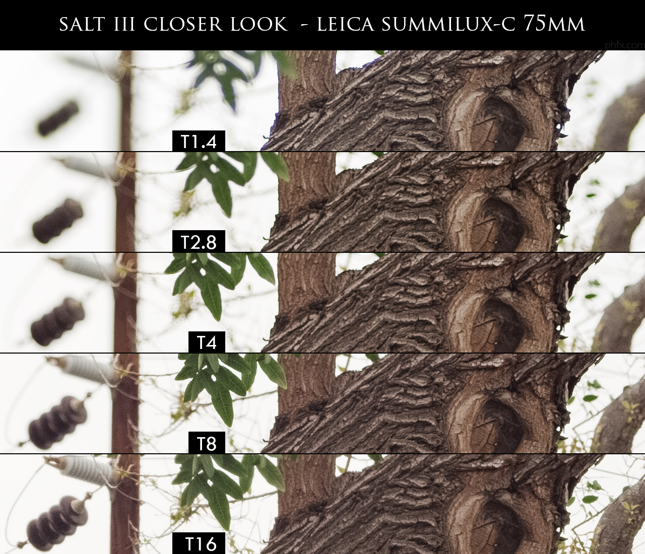

At the end of our tests we had a bit of time to do some real quick shooting outside and inside of Duclos Lenses. We all grabbed material of each other and tinkered with individual lenses that peaked our interests. I played with the three sets that most interested me and over the last week I've been playing a bit with grades and seeing just how skin feels on the glass I like. One graphic I wanted to show is actually running one of these fast lenses through some deeper apertures and observing the depth of field increasing. Here's the Leica Summilux-C 75mm T1.4.
In the above graphic you can see some very light purple fringing. You won't be able to judge critical sharpness from this sample set as this tree was moving a good amount in the wind. Check out the leaves and the power lines as they materialize. The leaves in particular are pleasing to me at the widest aperture. In a previous test with this particular lens I noticed that diffraction was coming into play about T11 and more noticeable, yet still very usable at T16. The Summilux-Cs for me "sing" from T1.4-T8.
Another thing to point out is that we are shooting 5K 3:1 REDCODE Raw on the Mysterium X sensor. Depending on what level of "crispness" you want out of the image is largely up to you.
In the above example at T1.4 we can carve a nice sharp edge from our 5K material to reveal all of the captured detail or create a more natural feel (perhaps more "film-like") by not touching the sharpness at all. Personally I tend to enjoy the look of a bit more detailed finished when mastering for a 4K delivery. That may even change based on my subject matter. The point I'm making here is you have the power and control to "sculpt" your final level of detail because we are shooting RAW.

The other set that fascinated me and is a bit more within my reach are the Illuminas. I'm very curious about these lenses and I took three lengths to the side to play with before tests were done. These also have a look I rather like, but in a different way. I like the creative aspects of a lens that flares like this and I can clearly see how the image cleans up and transforms very nicely stopped down. I shoot a lot in the T2-T4 range and they fit most of my wants. I need a proper set of prime focal lengths, which is one of the reasons the CP.2 Super Speeds and CN-Es aren't very appealing to me, there's not enough glass in their sets to be considered a full consistent range. The Illuminas are a full set with more on the way. Their build and size feels good to me. I'll certainly need to shoot more on them to fully get the feel of what they can do. I don't fully understand my love for this set, but they have gotten me to take notice.

Looks like LEICA rules.....
Any word how SCHNEIDER Cine-Xenar lll compared? Matthew?
I'll be testing these soon. They are one of the sets I'm eyeballing at the moment.
