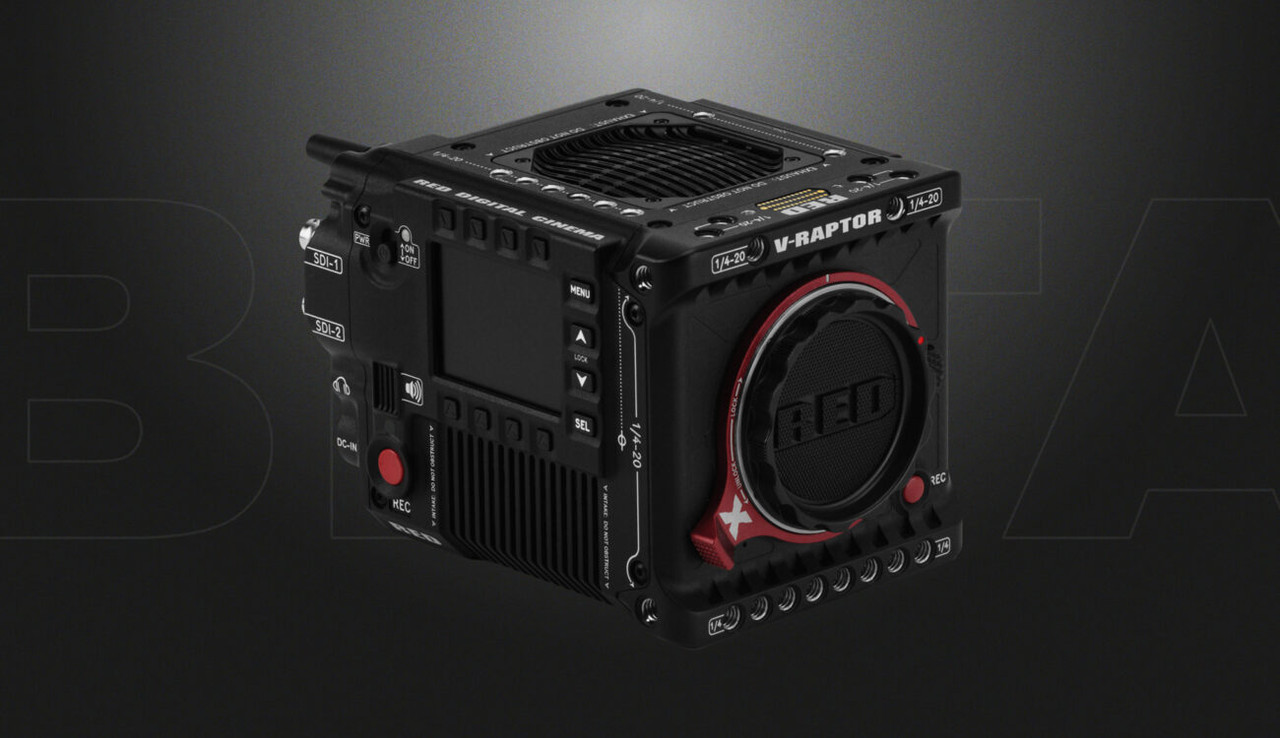

RED V-RAPTOR and V-RAPTOR [X] Firmware 1.7.2beta Released
