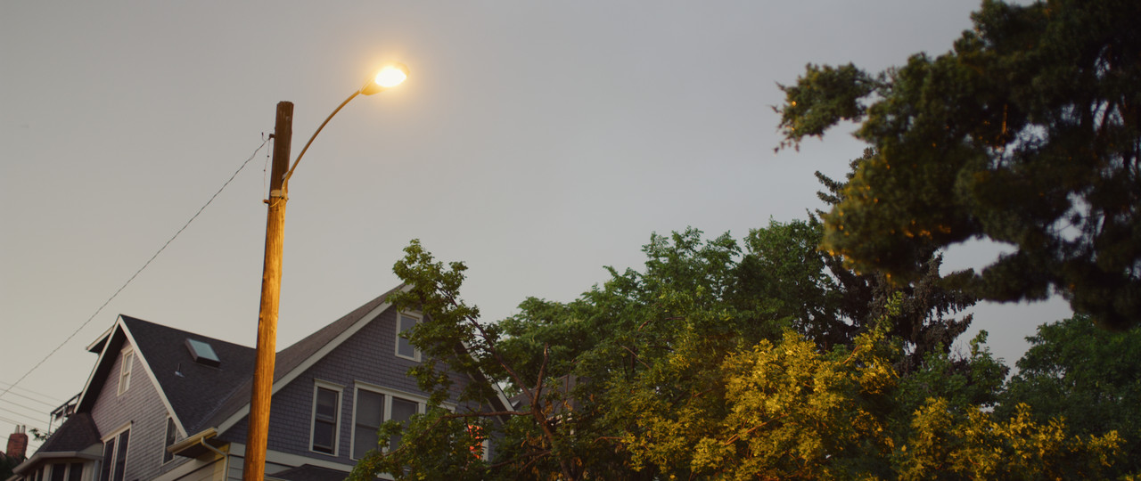

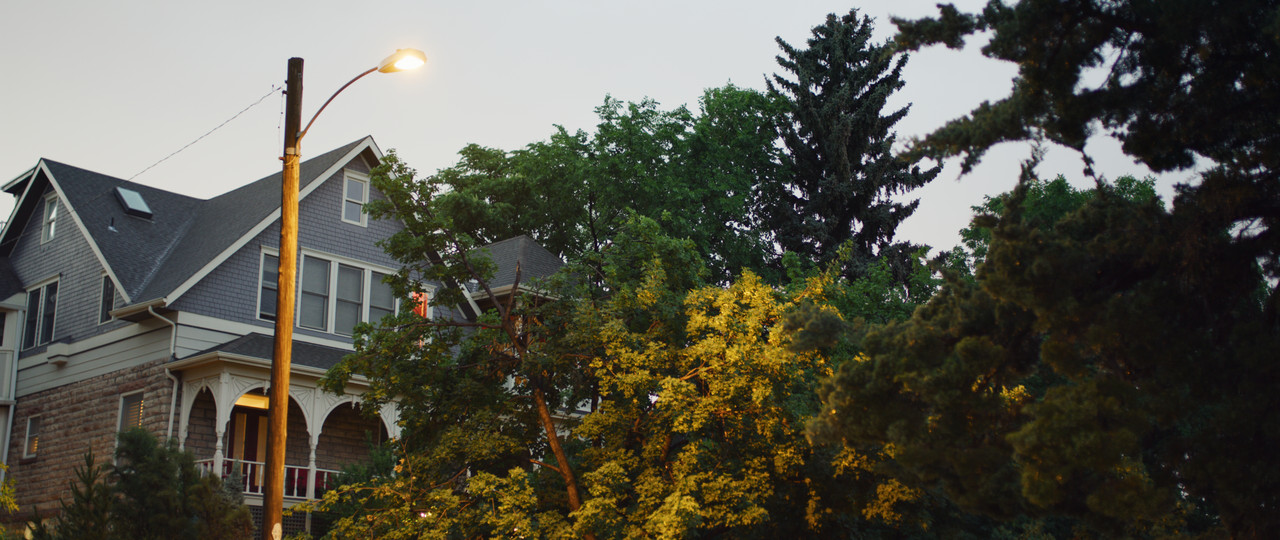

Hey all, checked out those clips already. Curious if anyone has samples at night or in very dark environments at 6400 or 12,800 ISO.
Here are some clips I just shot within a few minutes of each other, so the light should be pretty consistent between them. These are all 5K WS 3:1, using the standard OLPF. They're going to take a while to upload to Dropbox, so they might not be ready for a couple hours. You have some high-frequency detail, some light sources, and some smooth sky. Let me know if something else would be more helpful.
ISO 12800: https://www.dropbox.com/s/jv4j20m7ahj5bkl/A054_C001_0701EB.RDC.zip?dl=0
ISO 12800: https://www.dropbox.com/s/akeepiscgk4yedh/A054_C002_0701LZ.RDC.zip?dl=0
ISO 6400: https://www.dropbox.com/s/o30zakroey8vgx2/A054_C003_0701V3.RDC.zip?dl=0
ISO 1600: https://www.dropbox.com/s/xbha87tswyqyioa/A054_C004_0701FS.RDC.zip?dl=0 (with a bonus lightning flash)

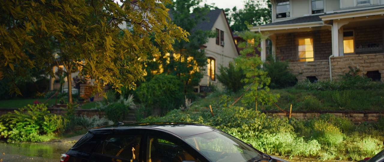

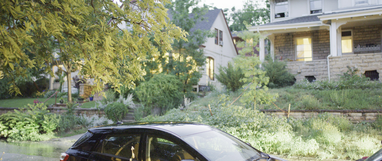

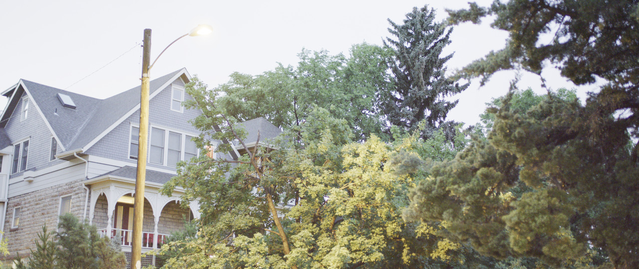

Alan,
The others are still uploading. However, here is your Original 1600 ISO clip(Top), and a grade I made along with a little "Temporal" Noise Reduction(bottom)

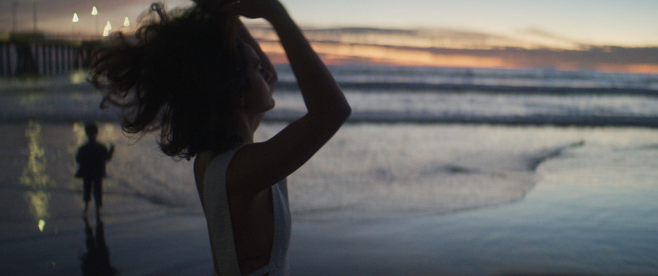

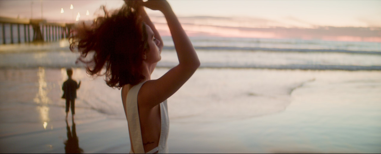

Alan,
Here is one of the 12800 Iso images I brought down to 3200 Iso and again I used a little "Temporial" noise reduction, with a warm grade
From 12800 to 2500 "Temporial" noise reduction

Hey Rand,
The foliage is looking pretty smeary in these - are we just seeing the extremes here? Is there something else going on?
PS. Thanks for all the info you've been posting, it's been really great!
N
Alan,
Nathan,
Thanks, yeah, I used some noise reduction in Resolve to get rid of the heavy chroma noise that existed after raising the ISO in these images.The unfortunate side effect was some smearing in the foilage.
