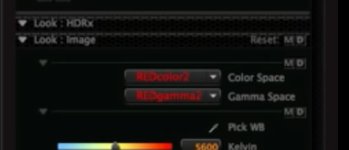

somehow from red interface disappeared these icon and i cannot return it. helpScreenshot-2024-06-03-at-11.52.5-11.jpg me to correct and return.
If I understand correctly, you're missing the older Color Space and Gamma options.
If this is the case go to
1) the Preferences (command ,) and go to IMAGE PIPELINE on the left.
2) at FILE BROWSER CLIPS at the top select SHOW LEGACY CONTROLS
Hope this helps

Thanks a lot Brian ! It works . I did it but in vain 'course I should restart soft. It say - for future projects . I looked through your site .The content in was shot by the Red cameras ?
