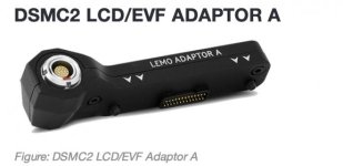

Any chance that Red or a 3rd Party will make such an adapter ? or maybe a Split cable ( Lemo 2 or D-TAP for power + SDI for Video signal TO Multipin Lemo for EVF / LCD )
Do we know about futur accessories that will fit the multipin accessory port of the Komodo ?
Red did retroffiting before.... I will love to use my EVF or trusty 5" Touch Screen with the Komodo

I'm quite sure that the main problem here is power consumption. The EXT Port can deliver 0.5A max., and the RED Monitors draw "a bit more" amps. Besides that, who knows if the RED Monitor's video feed is an SDI signal? If it's a different signal you would need a converter which produces lag - and that's why Jarred said (about a year ago) that it's not worth the trouble. Fair enough, he was talking about an adapter for Komodo's top interface, but the powering problem remains. *sorry*
