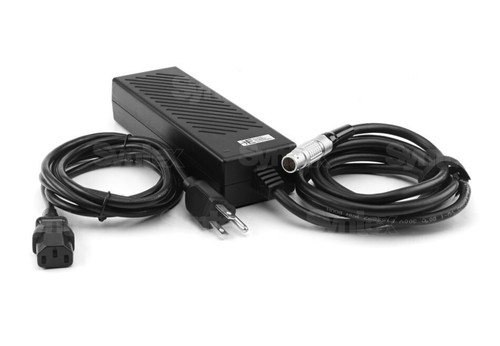

My OG RED Lithium-Ion Battery Charger Model CVTR2 no longer works as a 240V power supply to the camera, via the front 2B 6-Pin (Lemo) port rated at 13.8V 100W.
Are their any new products (from any company) that I can use for this function?
All I have found so far is a 16V 10A 240V power supply, and I'm not sure if this will damage the camera.
Any solutions are much appreciated.
Thanks
Quinn

I recently bought two from eBay for two of my cameras, used them, while filming for about an hour it didn’t damage my cameras but I am worried using them that’s the honest truth. So I got loads of v-lock batteries now so that I won’t run out of juice.
