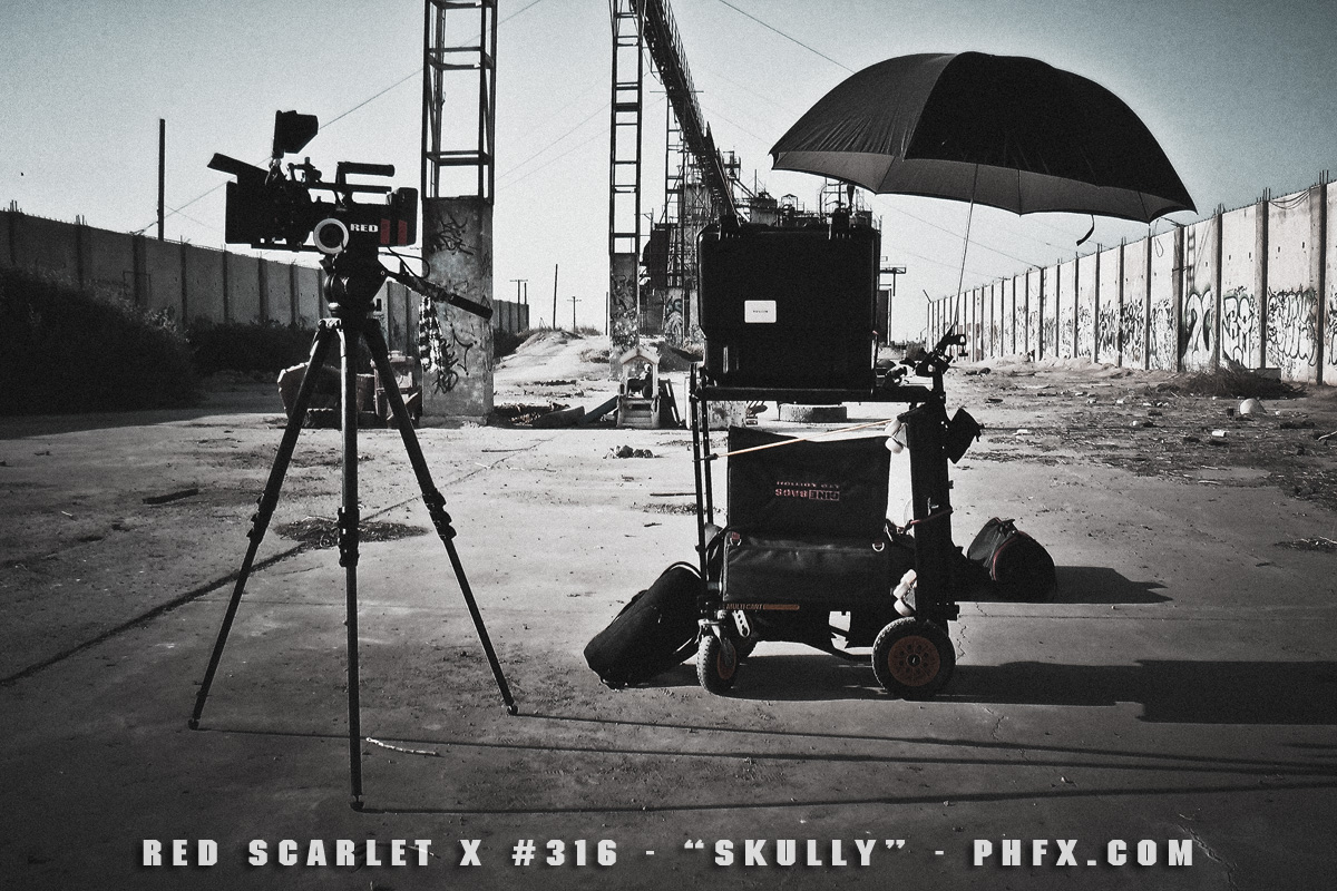

    Things I've done in daylight/hot/hell situations:
    -always have an umbrella, shade, hat, or towel
    -really handy to have them on a clamp - Manfrotto Super Clamp used above.
    -what my favorite thing to do is bringing an extra french flag with flex arm and attaching it on the back side or rods on top of the camera and shading it.
    I've only had issues when the camera has been on/rolling in the sun for way too long. But once I started giving her the "Cleopatra" treatment, she's been good to me.
