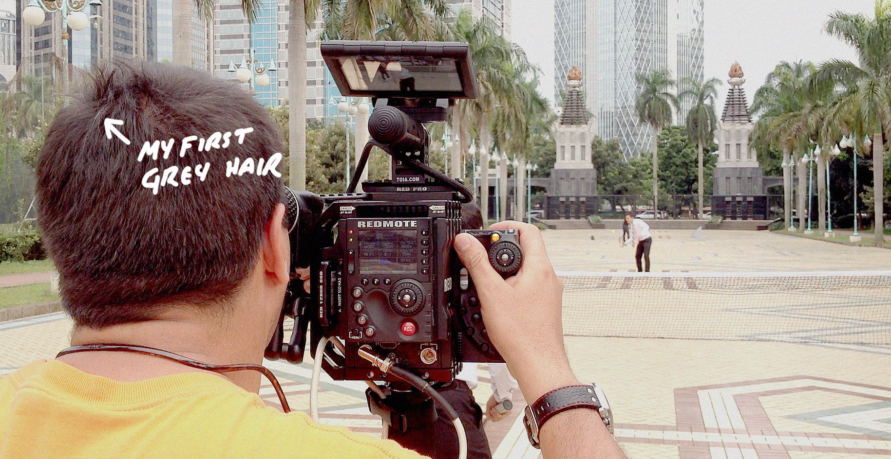

    Quote Originally Posted by Ryan Hamblin View Post
    Mark how do you have bot the LCD and EVF running at the same time?
    Cant tell you, will have to kill you....
    Kidding... I was dicking around in photoshop for fun to see if anyone noticed... :)
    Thats one feature I can only dream of... having both EVF and touch screen working at the same time with no modules.
    But we have all been told a several times now that is impossible.

    Mark, are you on a monopod there?
