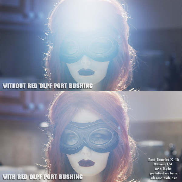

    Light hitting the front element, especially something real bright like the sun, can certain "soften the punch" of contrast and color within an image. I don't have any side by side examples on me, but I can show you light physically hitting the matte box and what it's protecting from:
    So in that example you can see the side and top flag is protecting the front element from the light source as it's casting a shadow across the matte box (top image). The image below shows just exactly where and what that light is doing. It's "dangerously" close to camera and without a matte box or flag of some sort it would introduce flare and glare to the image and thus reducing contrast and color.
    We are all familiar with typical lens flares, but there's a whole separate effect of "glare" within the recorded image.
    A somewhat extreme example and what Red's new OLPF port bushing protects from is this exact issue:
    That's an extreme example, but you can see the weird lack of color reproduction and loss of detail on "her" forehead area.

    ** Aha! I found an example of "with and without" glare/flare protection that I can show! In this particular case a french flag on a flexible arm was used:

    Wow, that is quite an example... And setting the flares aside - which even I would notice and make sure to eliminate one way or the other - this is exactly the type of washed out look I see all the time and that bothers me. I think I'm sold on getting the MB, if nothing else for my own peace-of-mind knowing that I'm not killing contrast without being aware of it.
