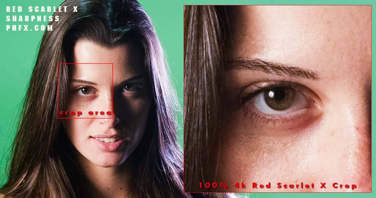

    This is what I am referring to, Phil Hollands example:
    [QUOTE=Phil Holland;943935]I've been following this thread from my dirigible fortress in the sky.
    Not having been there, inspecting the lens, or shooting these tests I personally have no real idea what's going on. However, I thought I'd show a 100% crop from a 4k motion frame for some comparison. This is a processed image.
    Even this 2K grab from the Scarlet is sharper:

    I agree with what Peter had to say. Besides shutter speed and focus; aperture, motion blur, filtration, etc. can all effect final image sharpness.
    Another not, remember 100% of a 4k frame and 100% of a 2k frame are identical in terms of what Scarlet can output at 1:1 pixel resolution.
    If you are interested in testing sharpness and want a tack sharp image off of a Red camera: find a stationary detailed subject, lock off the camera on a stable surface or tripod, stop the aperture down to f/8-f/16, shoot with a shutter of 1/250th or higher, lock critical focus with the 1:1 pixel zoom, and let it roll for 12 seconds without touching camera during that time. Try to keep the subject within 10-20 feet of the camera (if you shoot something a mile away atmospheric distortion can effect the image).
    I have a photographer friend who once wondered why all his product shots he captured on a very precise motion control rotating surface were always moving a bit after he started rolling. He most have checked out the smoothness and level on that motion control base for days. Upon entering his shooting are he was in a room with a bit of a bendy floorboard effect on thick carpet. Any time he moved his feet near the tripod he was effecting the shot, which is especially noticeable at the extreme macro levels he was shooting with a telephoto lens. He just never picked up on that slight movement and that he in fact was creating it.
